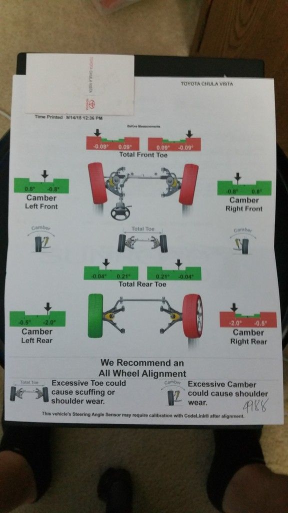

Alignment Issues after Lowering Springs
Here's the story, I recently purchased this at the end of July. 2 weeks ago I had the Eibach Pro Kit installed and went to get an alignment today at the Toyota Dealership where I purchased my car.
They said they couldn't align it because they don't have the kit for my car??
I asked what kit and I forgot what he replied with because I was so confused why Toyota couldn't align their own car.
Here's the print out they gave me after the test, and I'm confused. Do I need control arms for the rear? I picked my car up at 6pm so every other shop was closed and I'll be trying again tomorrow, I might go to Subaru maybe?
Any locals in San Diego know of any good alignment places where they could fix this when Toyota couldn't?
I'm just confused! Any help would be much appreciated thank you!

Purchase the front crash bolts,
Take it to a different shop, one that will work with you,
Tell them to max the front camber,
zero toe getting and rear.
Enjoy.

Read more about alignments on this car.
Stock does not have adjustable camber. If you want to adjust camber, you need camber bolts or camber plates up front, and lower control arms in the rear.
Stock alignment specs are for tire life and not for handling.
Any alignment shop can do an alignment.
I would personally get one or two sets of camber bolts up front, add camber(get an alignment) until its the same or more than the rear and just drive it. And then figure out what kind of alignment you want.

I'll purchase the SPC Camber Bolts and try to find a performance shop here in San Diego.
So with an alignment, the rear camber will get fixed without the need of a lower control arm? Sorry, just confused to how my rear camber will get fixed since to my knowledge there's no way of adjusting the camber in the back without these.
Thank you for the advice though, I'll try it!

Slow your roll.
Stock alignment is for long life tire wear.
Sporty/Track alignment is on the opposite end with more camber and less toe in the front and rear. Adding more camber in the front would make your overall alignment more track oriented. (instead of stockish front and trackish rear, which it currently is at)
Why is it odd that toyota couldn't do it? It's not adjustable to begin with and you have aftermarket springs.

So you're telling me they couldn't fix the toes of my car due to it not being adjustable? To my basic knowledge of cars I at least know that Toyota would've been able to fix the toes up front to the very least correct?
Camber in the front isn't an issue according to this diagnostic, only camber problem seems to be the right rear.
I really don't understand how Toyota couldn't fix the toes in the front. I know you seem very knowledgeable but you're only talking about camber. You aren't really helping fix the main issue here which is the front toes.

Toe is adjustable.
Did you pay?
And after they fixed the toe, the rear right camber would have been off, which is a red flag for alignment(for Toyota). Do it right or don't do it at all.
You would have paid, then driven, and noticed it not drive right, then complain and take it back only to be told they can't adjust it. Only to ask for a refund etc etc... not worth the headache.

Wow you should thank that tech for not charging and pointing you in the right direction. Most dealers and volume shops will just toe and go.
Rear camber is not adjustable stock and most cars vary left to right. If you just street drive its probably fine. Buy the $20 bolts, Max out front camber. Fix the toe to your liking and that's that.
I started that way. Toe out front toe in rear. It was good but I moved up to raceseng camber plates and SPL rear LCA. That's about 1000$ though and 120$ for a custom alignment at a good shop. That may be more than you want to spend but there are a lot of options in between.
