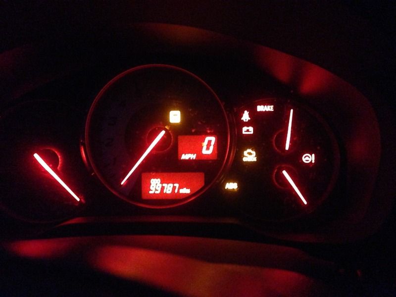

FI 100k miles update
So my engine is almost at 100k miles (almost 80k miles on boost).
Basically, everything feels the same as when I installed it at 24k miles. It still feels strong. Was at about 260whp on 91 oct for about 30k mile and 312 whp for the last 50k miles.
I use mobil 1 0w-30 and perform oil changes every 7.5K miles. I have the Vortech system at 9psi, but I've pretty much been using nothing but E85 for the last 50k miles. I beat on it everyday, but never tracked it since I dont have an oil cooler or a catch can. I believe for a DD, these are not necessary if your FI system has its own oil reservoir system.
I think it is safe to say the long term effects of E85 are ok for the FA20.
I think I can go another 100k miles without a rebuild, but we'll see.
