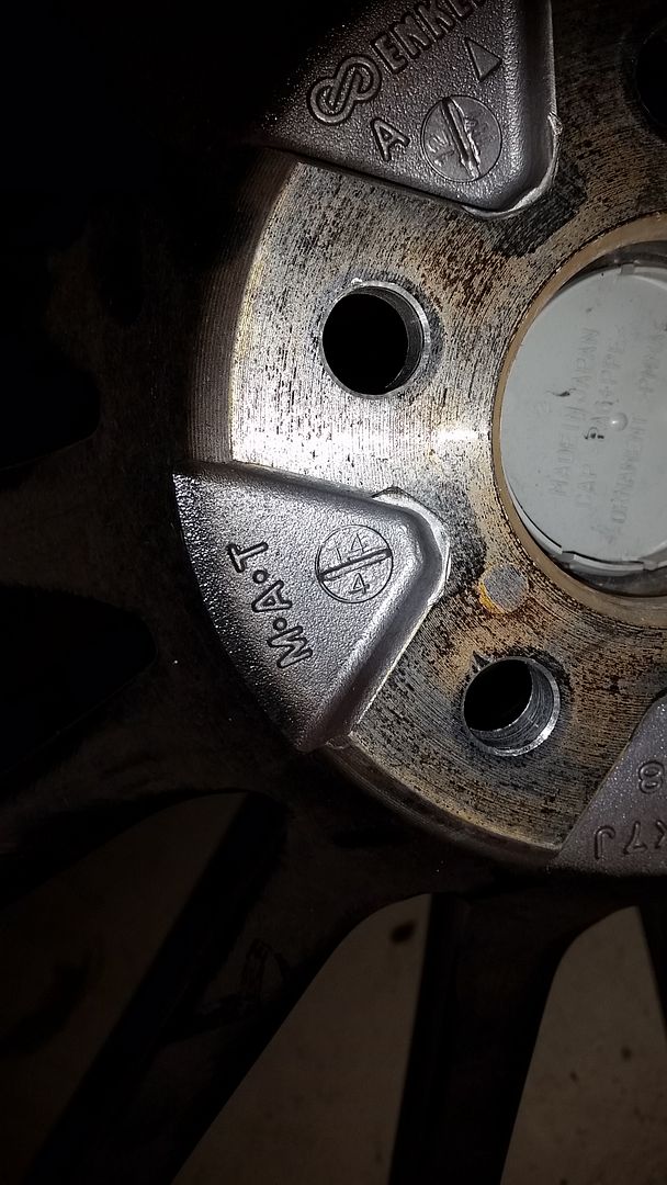

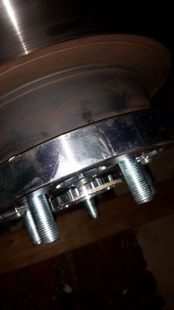

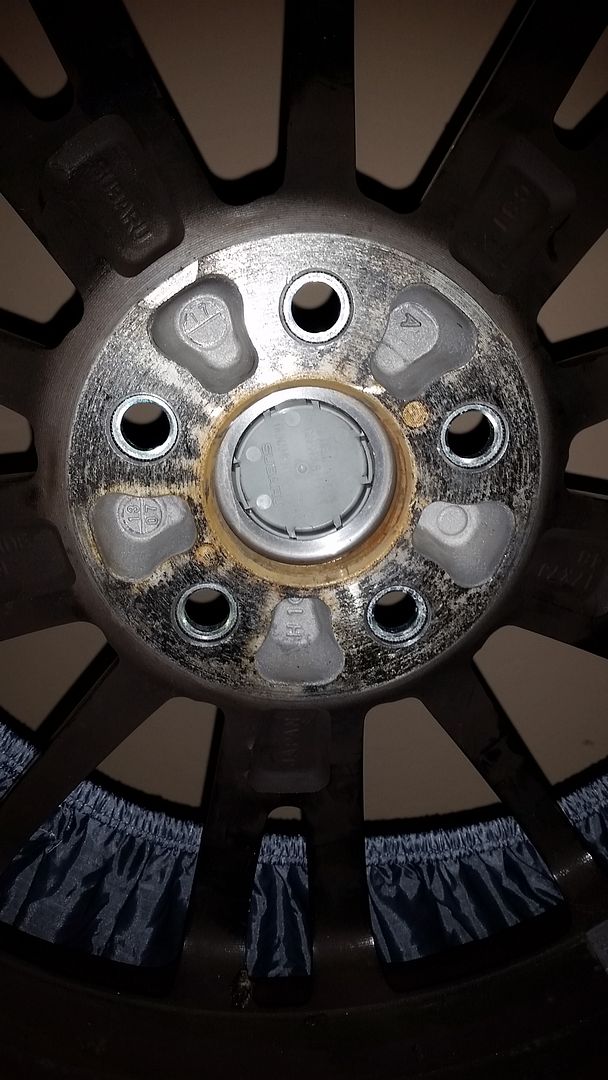

Alright well I found the culprit.
The front spacer lugs are not seating into the spaces on the back of the wheel. I don't know if its a matter of getting different lugs or spacers. Here are the some pictures to help you understand, you can see where the lug nut was pressing into the back of the wheel. Anyone have some input?

After looking on the manufacturers website I noticed it says "will not fit STI models" I guess I overlooked that not thinking about how I have the blue series STI wheels.
If you look at the picture of the OEM wheel it has much larger recesses and the spacer + lug does in fact fit.
So anyone know what bolt on spacer I can use with my blue series wheels? A quick google search and someone said the only ones that fit for 20mm are H&R and B2Designs, can anyone confirm this?
