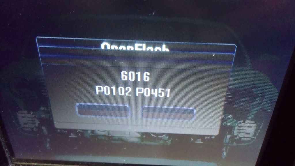

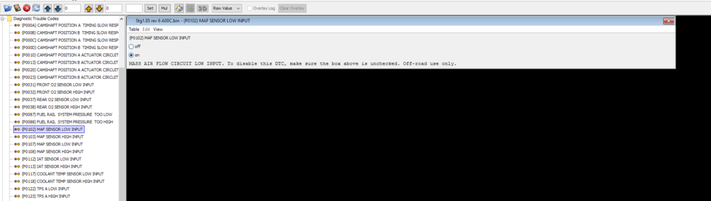

So I’m looking at doing a MAF delete kit on my FRS. I was hoping that someone knew a tune in RomRaider to accomplish this task. Now, I have it tuned to where it can run without the MAF plugged in or installed on the car, but I have a constant CEL with the error codes; P0102, P0451.
-P0102: Mass Air Flow (MAF) circuit Low input
-P0451: Evaporative Control System Pressure Sensor Range/Performance

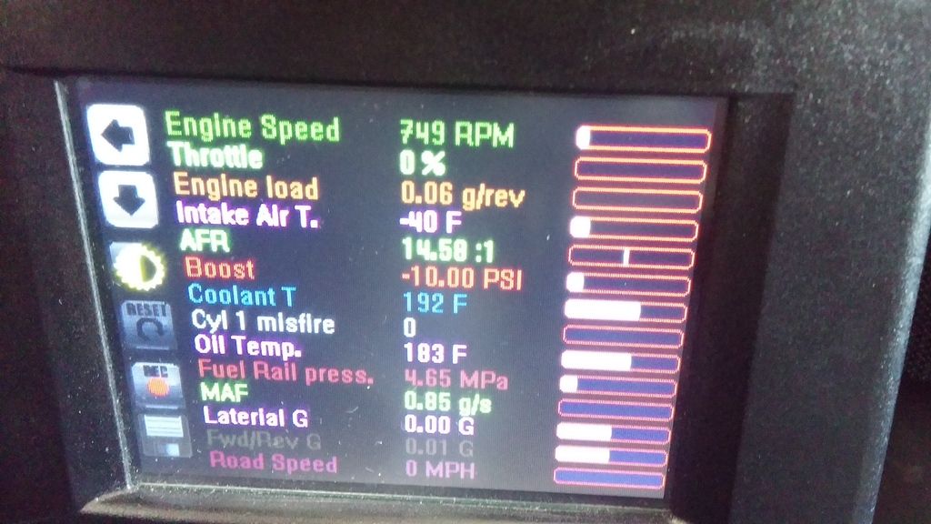

values that are off:
-Intake Air temp
-MAF
[ame="https://www.youtube.com/watch?v=Sv3hXHlcXQI"]https://www.youtube.com/watch?v=Sv3hXHlcXQI[/ame]
(A quick video on how she's running unplugged.)
