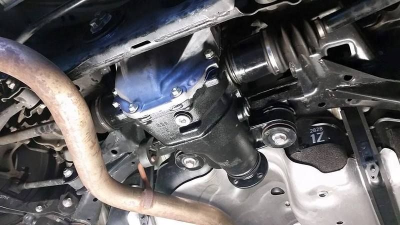

My car has woken up, it now drives like it looks.
I just finished my 4.44 final drive install. My car is currently just about stock so 4.44 is a mild choice but still woke the car up nicely. It doesn't feel like a econo car anymore.

I don't know how to capture it on camera without doing a before and after video. The car is just more eager to go and quick through the gears. With a stock motor is still not exactly fast but its way more fun to drive. I only did a 4.44 because I have a turbo going back on but this upgrade gave the car the push it needed to feel like the sports car it should be.
I got the gear set from MFactory, rebuild kit from Weir, and some seals and shims from the dealer.
I see people spending so much money on different exhausts and intakes chasing 2 more hp. Honestly if you are staying NA go with a 4.56 or 4.67 and it will be money way way better spent.

80mph with be like 3700 with a 4.56 final drive, stock is just under 3500, so my 4.44 should be around 3600. Not at all what I would call screaming.

I have charts from Cusco but cant load them up in a legible size. I went with 4.44 because I have a turbo going on so don't need to go as high.
