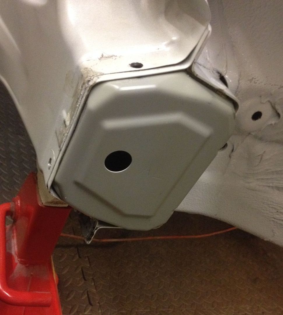

So, this is the area I'm talking about, It just gets in the way of big wheels apparently??
I plan to get rid of the extension by first removing the end plate, so the spot welds need to be drilled out..

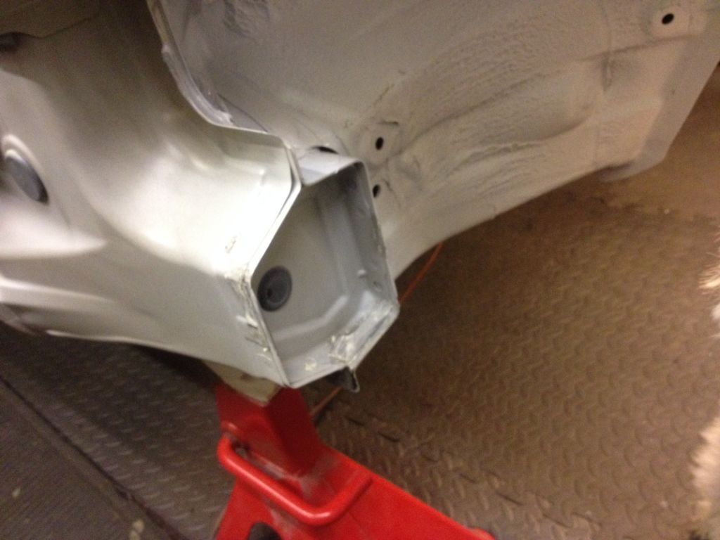

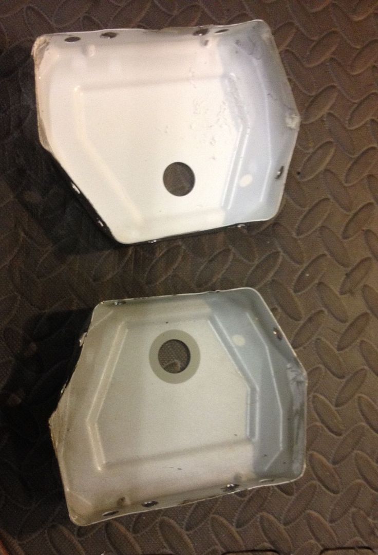

And the end plates removed from both sides of the car..
After shortening the extensions down, I plan to insert the left endplate into the right hole, but backwards, then I can achieve a tidy stitch weld all round the aperture.
Note in this pic, the extensions are not yet shortened..
I have a question, how much do I remove from the extension? Has anyone here done this and have pics of the job they did? I'm doing this now while the car is apart, it will be a Rocket Bunny in the near future..
