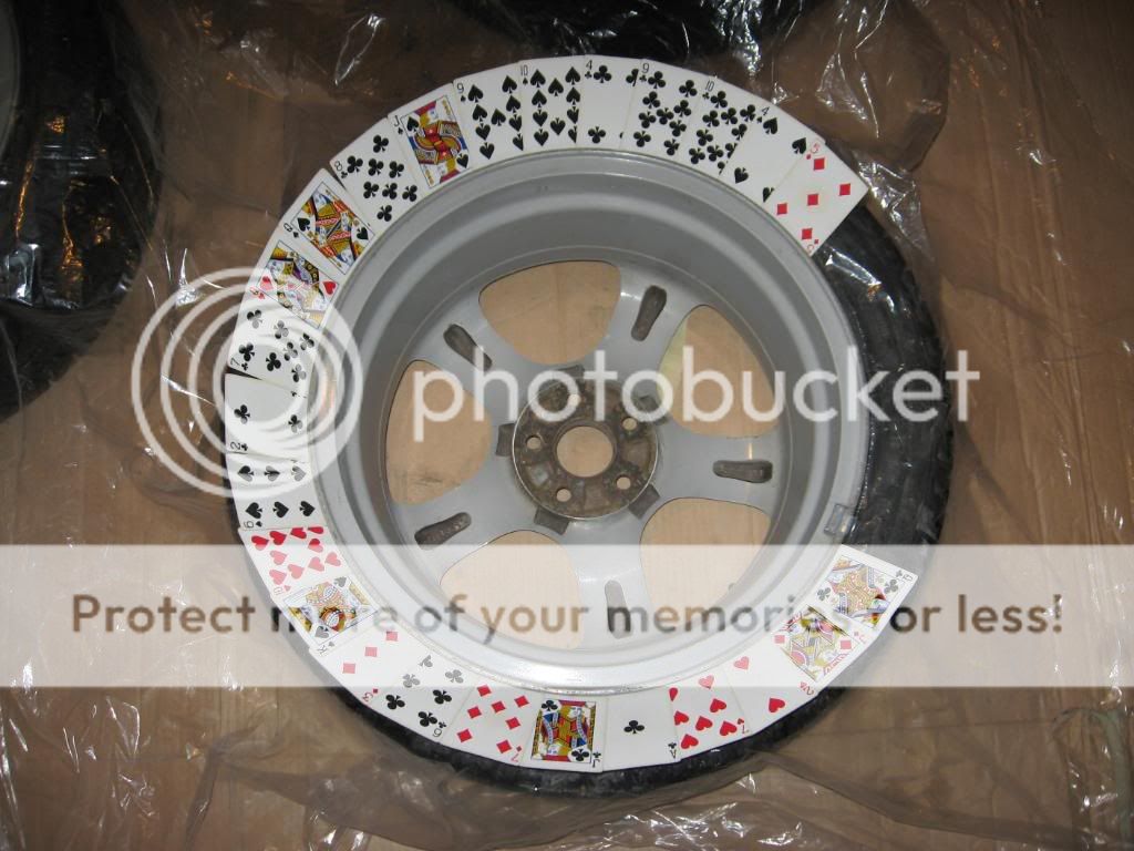

You can use dollar store cards to "mask" the tires if the wheels/tires are already mounted.
