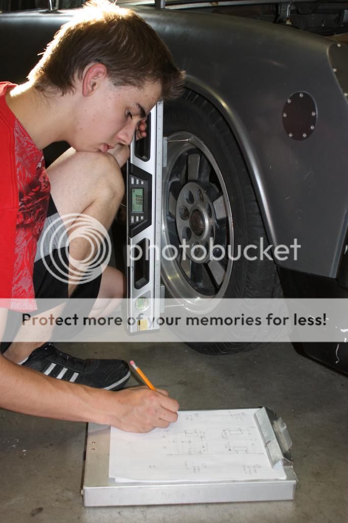

I use a craftsman 3 foot digital level.
It has magnets on it to hang on things.
I used those magnets to hold on steel 1/4" X 14" bars that I threaded some small bolts into.
The bolts stick out from the side of the level just enough for me to touch the rim on top & bottom.
It seems accurate to 1/10 degree.
Here's my son measuring
That looks freakin' fantastic.
Ummm.... what car is that?
It's my other 2.0L boxer engined track car (Porsche 914)
