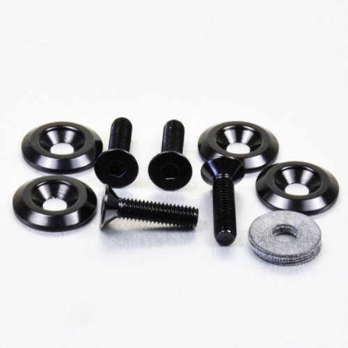

My downforce front lip came pre-drilled, but no hardware. I went and purchased some 6x25mm countersunk bolts/washers, like this:
Then went to the hardware store and got rubber washers that matched the diameter, and some nylon lock nuts. Mounted in the existing holes underneath the front bumper. So if the mounting points aren't even dimpled on your lip you can always remove the bumper, line up the lip, and drill down through the mount holes in the bumper.
As for skirts, I'm pretty sure there are no pre-existing mounts on the car. Most people just sink some self tapping screws and cry themselves to sleep over it.

Yep. 6 is all you need.
And some 3M double sides tape for insurance.
