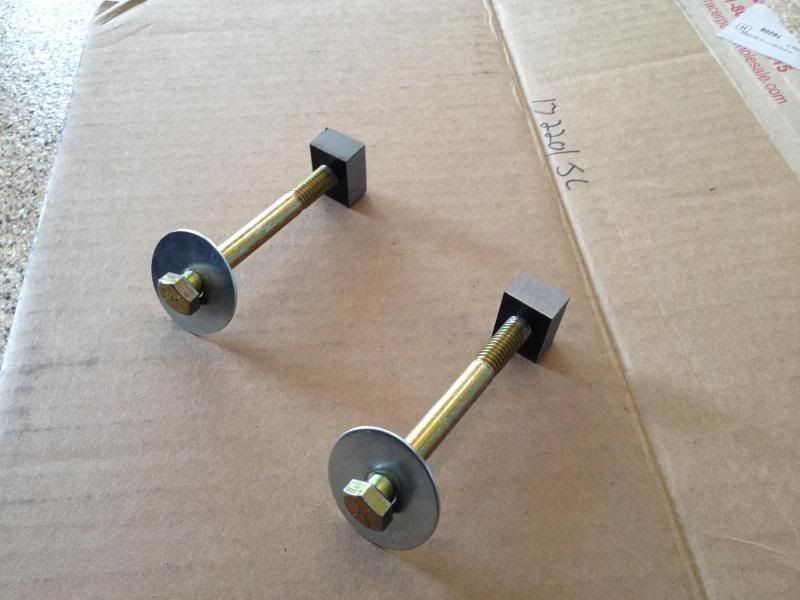

Next I used 3/8" x 4" long bolts and fenders washers that attach to some 1/2 thick steel that I cut/drilled/tapped to be used as nuts.
The nuts fit just inside the square aluminum so they do not rotate and make for easy install.

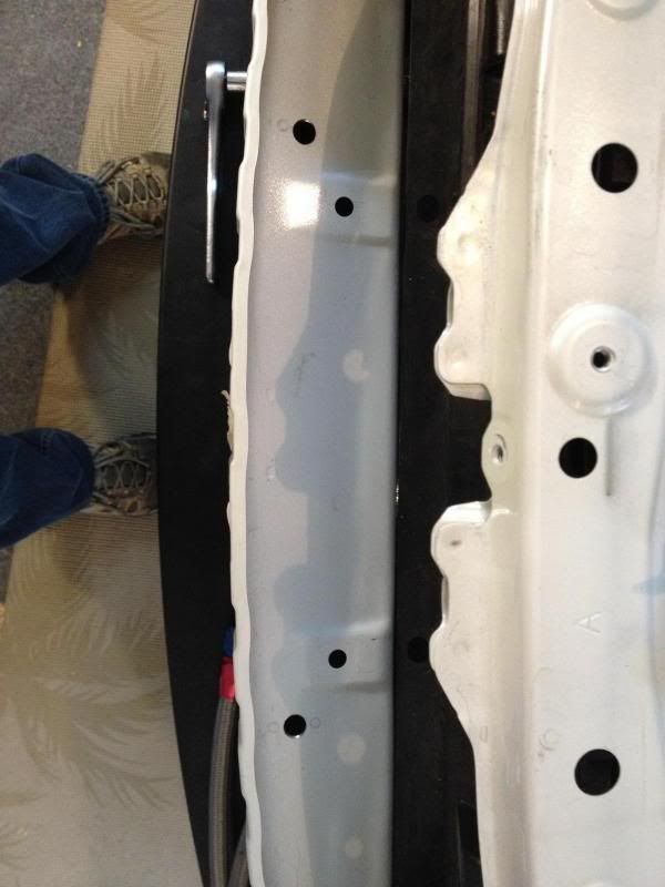

Now for what may not be to everyones liking, I drilled four 1/2" holes in the crash bar to put the bolts through. IMHO they almost look OEM with the cooler removed and would not be noticed by any service tech as abnormal with a little white touchup paint. One could debate about the holes comprimizing the integrity of the crash bar or causing it to fail in a different manner than designed, but based on all the other holes and some of my own engineering knowledge I highly doubt this.

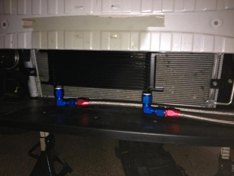

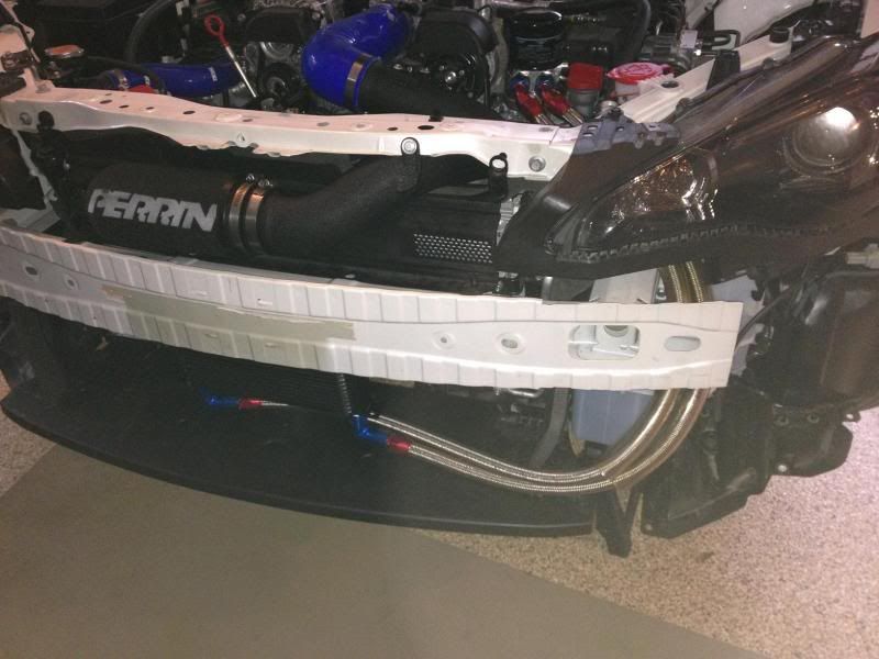

Here is the cooler bolted into place. It is a very sturdy mount and you could actually adjust how far back the cooler sits by making the aluminum tubing longer.
And one final pic to show everything hooked up and routed.
