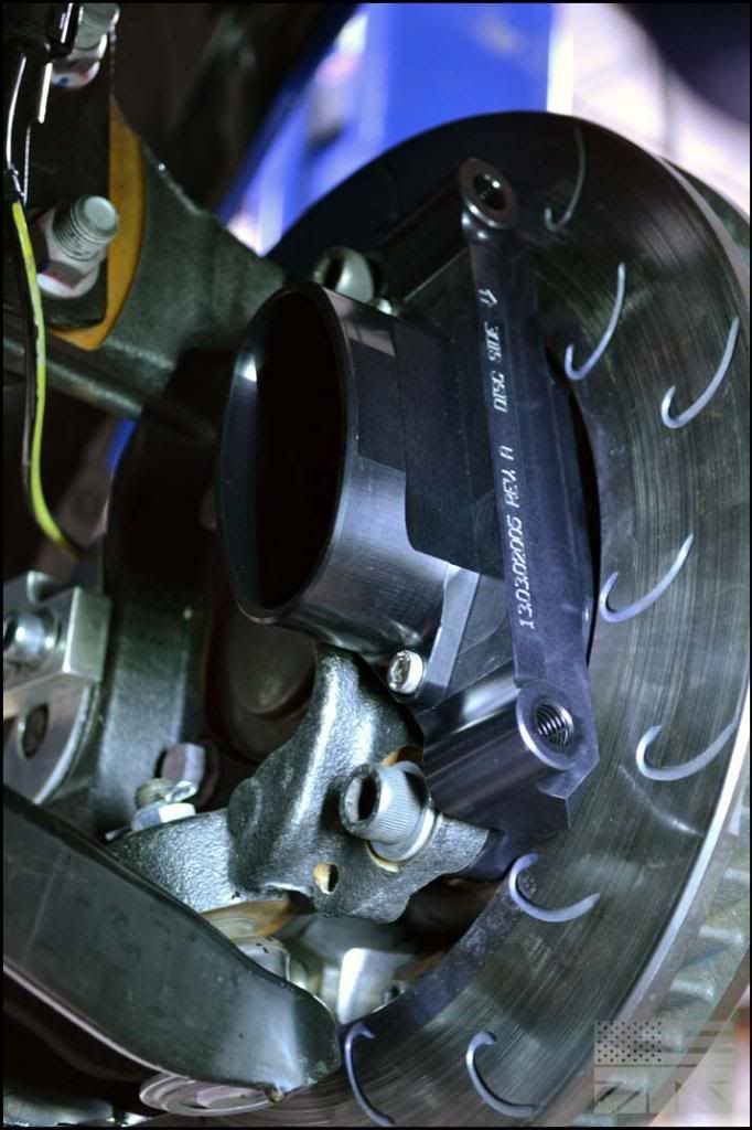

Ended up going with an ap sprint kit shortly after making this thread. So far its handled 20 minute sessions at nhms and thompson with 0 issues running cl rc5+ pads. Car does have an sc, others on the same setup seem to be in the 260ish whp range.
I added this last week on a whim after having read that others (gtr) had mostly positive results especially relative to the cost and effort. For about $16 (bed bath and beyond is the only local place with nice silicon flippers) and some zip ties its well worth giving it a shot.
IMG_6713 by utekineir, on Flickr
What's the theory behind that?
