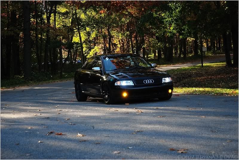

Many HID yellow bulbs are just a regular hid bulb dipped in a yellow coating. It makes them not as bright and they're not that yellow. I usually recommend to customers PIAA plasma ion yellow bulbs along with lumin-x yellow over the fog housing. That also aids in protecting it from rock chips and fading.
Heres a pic of my old car with this set up

Finally, some feed-back! Great picture as your Audi is representing pretty much what I am looking for. I previously poked around Tire Rack to learn up on yellow HID bulbs and ballasts. That said, I won't hesitate to check your site out
I will check out your solution - all I am looking for is some good, long wave length light at sufficient intensity to cut through fog and rain.
