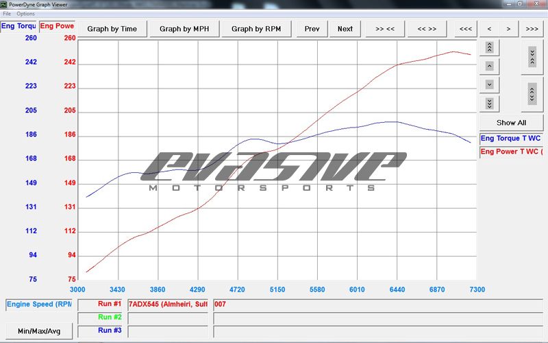

FA20 Club Turbo Kit ***Evasive Tuned 251whp with 6psi***
We tested about every turbo kit you can think of Greddy, FA20, and AVO. The FA20 Club being a bigger turbo then Greddy made around 251whp on our Mustang Dyno on 6psi of boost. Less boost as the Greddy but around this same power output. The FA20 Club turbo was a little laggy from being a bigger turbo then the Greddy but still made good power.
Set up
WHP 251 TQ 197 Mustang Dyno
FA20 Club Turbo kit @6psi
Evasive Fuel System
Invidia Exhaust System

Nice, which turbo is this?

FA20club UEL 60 trim
Thats my cousins car i couldnt come pick him up when you guys had issues with the maf.
Edit:
I Drove this car yesterday( I drive it a lot but i never liked touching it with tonis map as i always knew it could blow up any second ) and hoon'd the hell out of it i really liked the tune its a huge improvement from toni's map, night and day difference ! Sadly we couldn't dyno the car with tonis map as fuel mods were installed before the baseline pull, Butt dyno notices a huge improvement. One thing i disliked was the rpm's would stick at 1500 or so sometimes after a rev or while reversing another thing i noticed the car idled @ 12;x afr or so give or take not a huge issue . i did manage to set a CEL off for some reason and i think he's going to follow it up with you guys. The kit is the biggest mistake we did( As i help him with his car); we regret buying this kit and even the guys at evasive dislike seeing it ( Hey i don't blame you) We have plans of taking it off and selling it for something else but funds for him are an issue atm.
