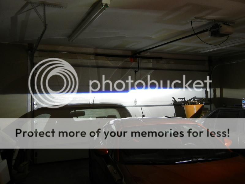

In the next few weeks, I'm hoping to stick some RX330 non-AFS projectors in mine using OEM Matsushita ballasts and some Philips 85122 bulbs. Time frame will depend on the weather cooperating for painting purposes and whether or not I need to tune the projectors too much.
While it's apart, I think I'm going to throw some HID projectors in the fogs as well, but I want to see how sharp the cutoff is once the bulbs come in. After that, I'll decide if I want to use the HID projectors or if I'll go with the OSRAM LED projectors.
speedrye is offline   Reply With Quote

I'm pretty sure these will be a direct bolt in. Literally unscrew the stock projectors and screw the new ones in (once sharpened/tuned), but we'll see... If I do need brackets, I'm pretty good with AutoCAD and getting things laser cut, but I'm hoping it won't come to that.

Still needs tuning, but it's a good start. I'll post up a thread before too long. Ignore the light above the cutoff, that's just reflections from the cars:

Direct bolt in like you suspected? I wonder if they'll bolt in to winjets..
