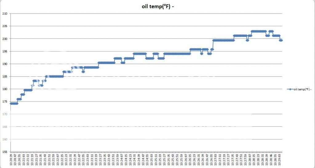

Originally Posted by Suberman View Post
Oil temperature is not measured on these cars.
Logged via OBDII port on my Droid:
