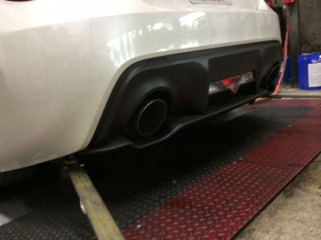

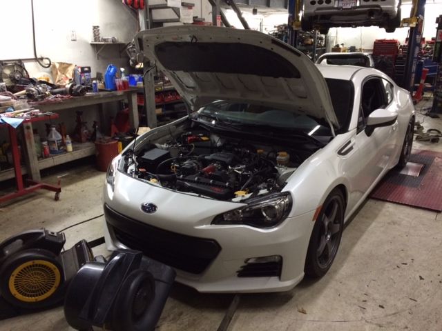

hi guys,
Just did a custom tuning job on mkivsoopra's BRZ. It was a cool project because it represents a max effort NA set-up. His car pretty much has every performance mod possible. And it runs exclusively on E85. Which means that it could (and perhaps it did) break some NA dyno record for the FA20.

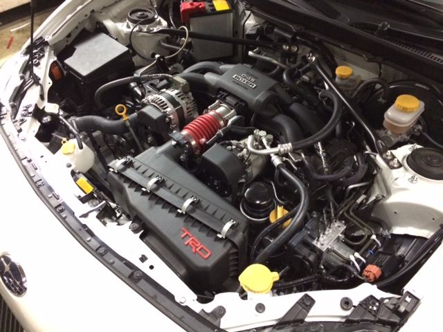

Modifications (@mkivsoopra please correct me if I'm leaving anything out):
-TRD Intake box
-JDL UEL catless header
-Nameless over-pipe high flow cat front pipe
-2.5 full exhaust
-lightweight pulleys
-Carbon fiber driveshaft
-Exedy clutch
-Lightweight flywheel
-Lightweight SSR rims
.. and of course an OFT running our off-the-shelf Stage 2 UEL E85 map. Baselined at 204whp without any tuning. After an hour of custom tuning, we picked up another 3whp and smoothened out the curve a bit. There really wasn't much to gain
Dyno runs shown below (with the stock baseline from my car):
Car felt great just driving around the parking lot. Super revvy and racecar-like. Easy to stall if your not used to it though! Sounds like the next time I tune the car it will have a turbo… can't wait!
