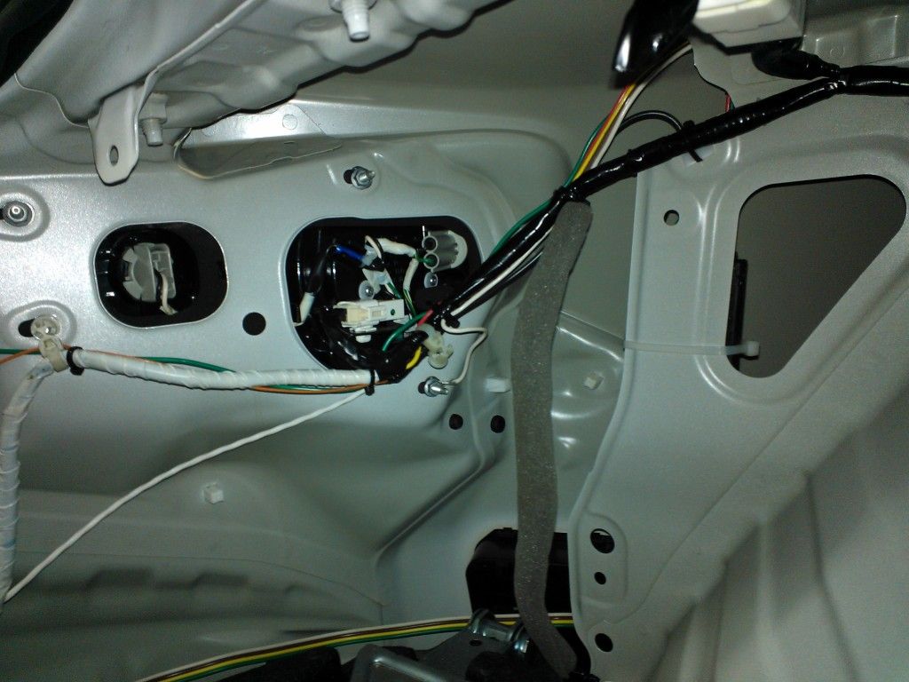

Hey guys, this isn't going to be a super detailed DIY but I have been getting a lot of questions about wiring trailer lights. Hopefully this will help clear up a lot of those questions and give people a good start to wiring trailer lights.
To wire trailer lights on an FRS/BRZ you will need to purchase a powered converter like this one: https://www.etrailer.com/Custom-Fit-...urt/56146.html
A basic overview of the wiring that needs to be done:

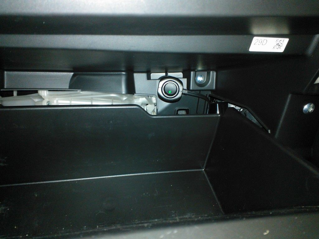

The converter uses an external source for power and does not put an extra draw on the tail lights. The power to this converter can be taken from almost any fused power source that is on with the ignition. I decided to use the glove compartment cigarette plug since its easy and I don't use it for anything else. So in that case you will need a universal outlet plug.
Wiring of left tail in progress:
Completed wiring on left tail:
Wiring on right tail:
Mounting location of Curt adapter near left tail:
Semi-completed wiring on left tail showing a better view of the mounting location of the Curt adapter (right)
Power adapter installed in glove box:

FWIW - I used the same harness but just ran power from the tail light. I actually just spliced and wrapped with electrical tape. I haven't had any issues. There isn't a ton of slack in the OEM wiring, so just take your time.

Where did you guys run the wiring to the exterior, on most vehicles with trailer hitches the wiring sticks out right by the hitch. I've got the plug and play everything just need to know where to pop it out?

Through a rubber plug under the spare. Then between the body and exhaust heat shield.
