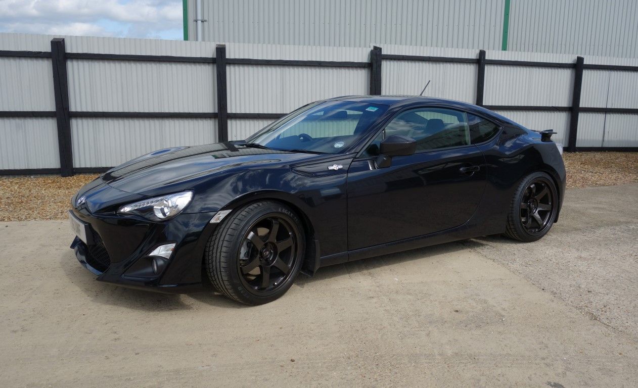

I have them fitted to my car. Although it is early days, only about 1000 miles with them, I certainly have no regrets. The ride is just as good as with the standard springs. I also had the wheel alignment re-done after having them fitted.
Here is how my car looks with them:

Thanks! Great looking car btw.
Rota grids?

These wheels 8.5's up front?

Rims / tires are
Rota Grid 18 X 8.5 ET44 Fronts
Roto Grid 18 X 9.5 ET38 Rears
Goodyear F1 Asym. 2 225/40 front, 245/35 rear

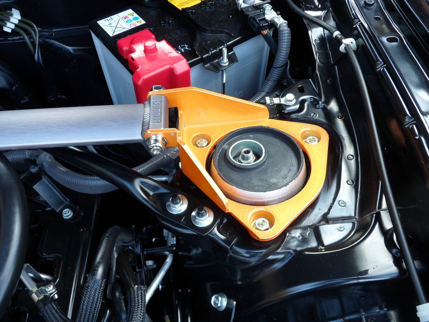

As well as the Eibach Sportlines, I also have had fitted
Whiteline 16mm adjustable anti-roll bar
Summit Swave Rear Adjustable Toe Control Arm Set
Summit Swave Rear Adjustable Camber Control Arms
Fensport Front Camber Adjust Bolts
Whiteline Offset top mounts
Summit Swade Front Strut Bar

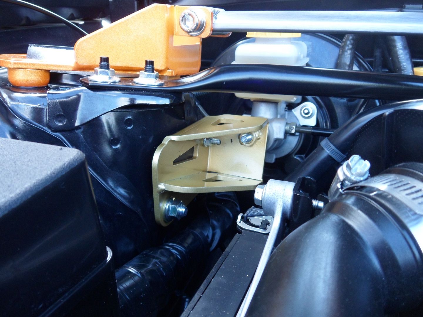

Beatrush brake master cylinder brace
