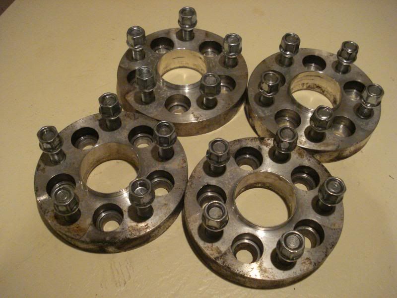

But they used spacer adapters, they used 04 STI brakes.
There's zero evidence that they used different hubs, but there is visual evidence that the wheels are pushed out farther than they should be, likely due to spacer adapters.
They also had the car for a week, spacer adapters would have accomplished what they wanted with zero effort so they could spend the time on stuff they had to build jigs for like the exhaust.
