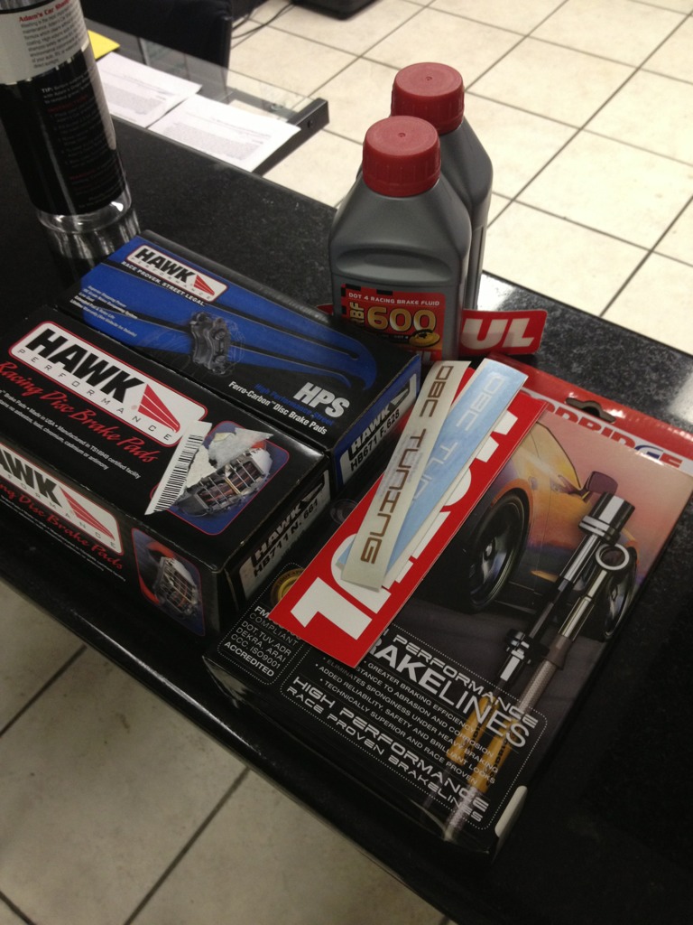

Still need to get these on the car but this is the setup ill be daily driving and having fun with!

Originally Posted by tuckdaddy View Post
Attachment 36270
when do you plan on setting up? im interested in how that setup will work for DD.

Shooting for Wednesday! I'm not too sure how the race compounds for the front are going to be (street able or not) but the HPS's are a solid pad! Wanted a good setup for runs and eventually when I can figure out track days and autocross but still be a streetable setup. I'll be sure to fill you in on my impressions of them. I think from the research I've done and just having buddies who continue to buy these for their cars and swear by them they'll be a good setup.
