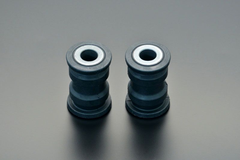

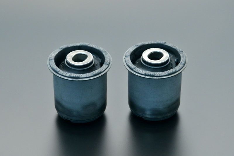

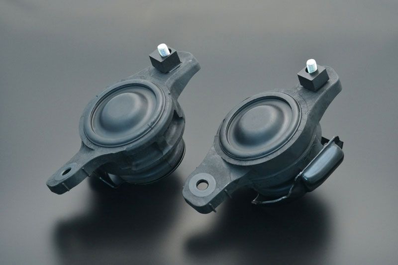

The STi Page has been updated with the new Chassis Mounts.
http://www.sti.jp/parts/catalogue/brz_zc6/1.html
Engine Mount:
Transmission Mount:
Differential Bushing:
Subframe Bushing:
Steering Bushing:
Beyer Subaru is offline   Reply With Quote

From the looks of it these are hard rubber mounts vs. most of the aftermarket which are poly. I don't have experience with STI mounts, but in the Honda world I have had a couple cars with the Mugen hard rubber bushings and for a DD I would much rather have the hard rubber vs. the poly mounts. Still have the improved response, but not the direct translation of vibration in a lot of cases.

I have had Group-N (hard rubber) engine mounts before. Only change in NVH was at start up. Could I get even LESS movement with poly or a solid mount? Yes. The trade off in NVH is not worth it for me. Rubber is the way to go.

Rubber vs. poly discussion for the bushings. One is not objectively better than the other, they just do similar things differently. Rubber should be less prone to noise and need less re-greasing. On the downside, you're going to have to press those bushings in whereas most aftermarket poly bushings will be split design so you just have to get the old bushing out (not necessarily with a press ).
