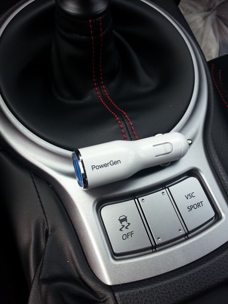

I bought a powergen on amazon for like 10$.. Charges fast 2amp works very good on my iPad /nexus 7/GS3/iPhone.. Its like begin plug to the wall.. The USB port on FRS don't even supply 1 amp of charging power that's why it charges slow..
