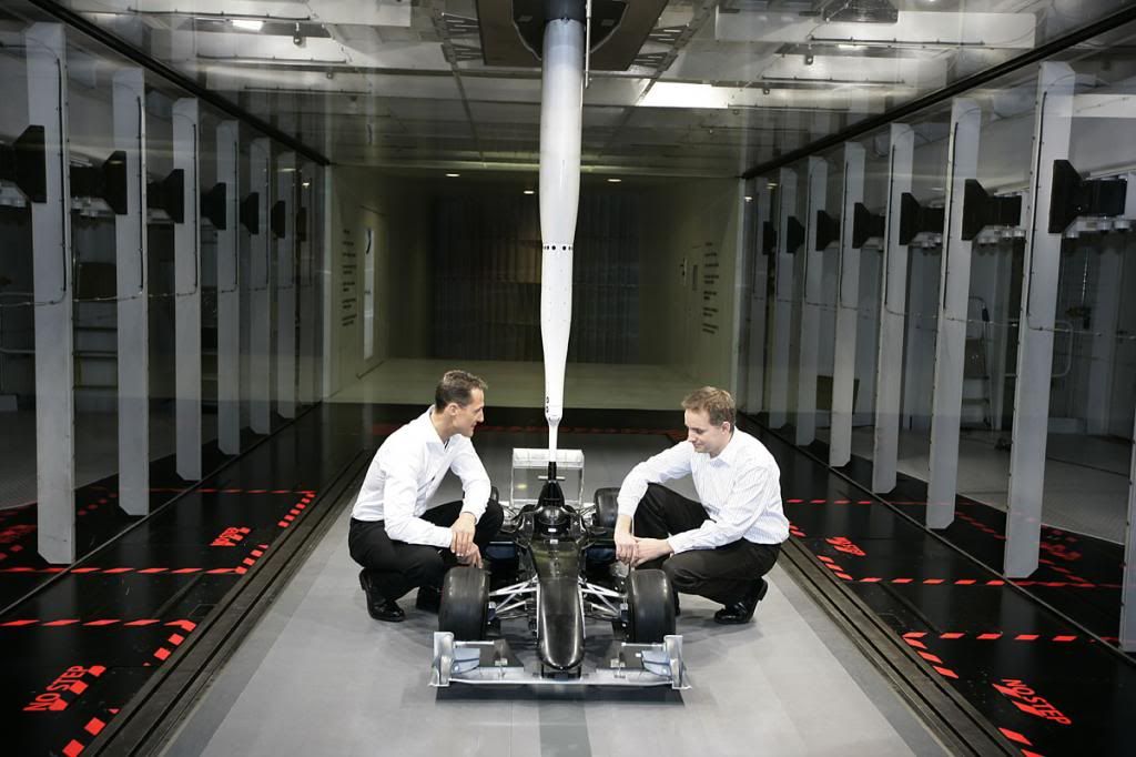

Another issue with tunnel testing is scaling. If you use a scaled wind tunnel, you need to appropriately scale the model to get useful data. This is due to Reynolds numbers and Reynolds scaling (stuff I would need to brush up on to fully explain since it's been a while since I took fluid mechanics, I'm sure plucas will jump in to explain later). Notice this picture of a full scale car and how small the wind tunnel is:
Now notice this picture and how the tunnel appears to be similar in size and how small the model is:
Now who's testing to trust? An aftermarket company that shares no results of its wind tunnel testing or Mercedes AMG F1? Another issue that arises with using a scaled tunnel scaled models are the scaled model must be that much more precise and the surface finish must be that much better.
Now, does that mean the products don't work or aren't "aerodynamic?" It depends on your definition. Aerodynamics is the study of the motion of air and its interaction with objects. So, by that definition, anything that affects the flow of air is aerodynamic. This includes opening a window and sticking your hand out. Now, how effective and how efficient that part is must be quantified and tested through real life, wind tunnel, and CFD.

On windtunnel testing:
I did my senior project in the subsonic windtunnel at Cal Poly San Luis Obispo. I was testing the efficiency of various small electric motor/propeller combos under different conditions. The wind tunnel was ~4'x4'. The professor that ran it told me not to test anything larger than around 1' in diameter if I didn't want the boundary layer of the wind tunnel to start messing with things. This was partially because I was testing propellers that have relatively complex things going on. But. That's 1.5' of boundary layer on every wall of the tunnel. Depending on the speed you test at, this will be smaller or larger, and this boundary layer velocity gradient will have an affect on your test results if you don't take it into account or size things appropriately.
