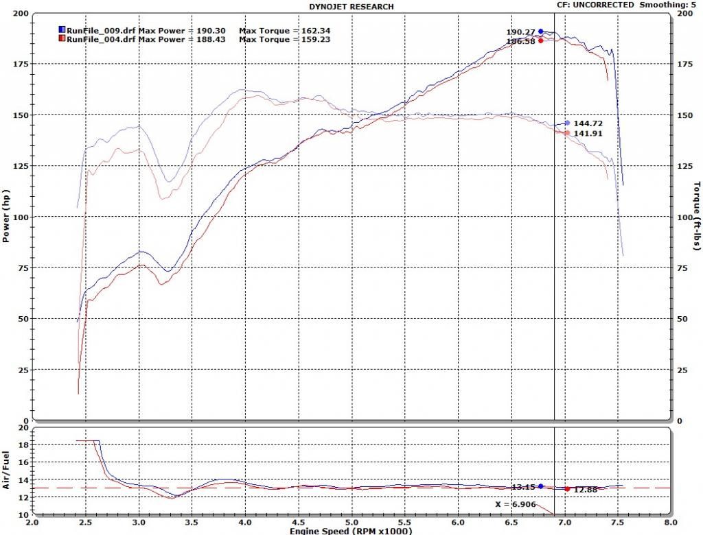

Visconti's final production dyno of the Vortech SC kit.
*note that this car had an exhaust system on it, by Visconti's won admission. I don't know the details of that exhaust system nor how that would have effected the results.
Here is 91 octane testing I've been doing
Nameless's preliminary dyno for their unfinalized header and exhaust system. IIRC it was said that they are using 92 octane here.
Originally Posted by johnbradley View Post
If I get in trouble for this I am blaming all of you
Please keep in mind this is just the prelimn. I have mountains of data to go through and figure out why it is what it is.
Yes, the header and exhaust in johnbradley's post isn't giving the gains in the upper part of the rpm range. But when you consider the costs of the two, including the installation costs, what they will do to the warranty, and the fact that Nameless is working on an intake manifold I really think Nameless is going to be able to get better gains for much less money and they will certainly still have the NA predictability and feeling.
I'm just wondering if others in this FI forum are thinking about this, and if so, what are your thoughts?

you can't comapair results from two different dyno's man. I made 175whp on one dynojet in my area on the stock tune stock car... I made 165 on another dynojet in my area also on the stock tune and stock car. The latter was 250 miles after the former. They were even the same model dynojet.
You need to look at before and after on the same dyno or the comparison is about useless. What you can often do is look at what the same or another stock car made on that dyno stock then look at percentage gains.... if a dyno reads high the gains will be high but percentage should be the same from one to another.

53whp is a lot. I'm on the fence on staying na or going fi. I'm waiting for a set of proper na cams. Without those, the engine still has a VE problem. The header might be amazing for the dip but it doesn't do much for the top end. It still rolls off hard. The Visconti setup there is making power at 8k. It would prob make power at 9k.

not to mention that those nameless numbers are uncorrected
