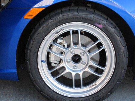

New Set-up for the BRZ.
Enkei RPF1 17x7 42
BF Goodrich G-force Rivals 225/45/17

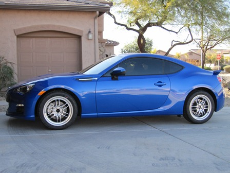

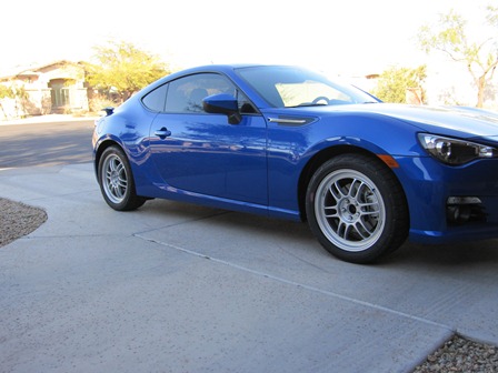

Name:  side angle.jpg

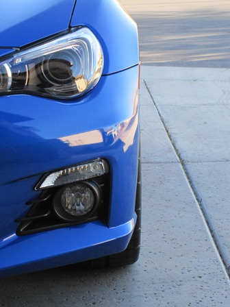

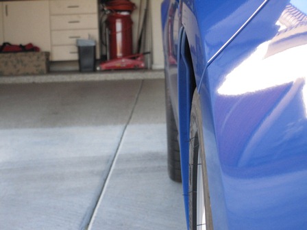

Front view.

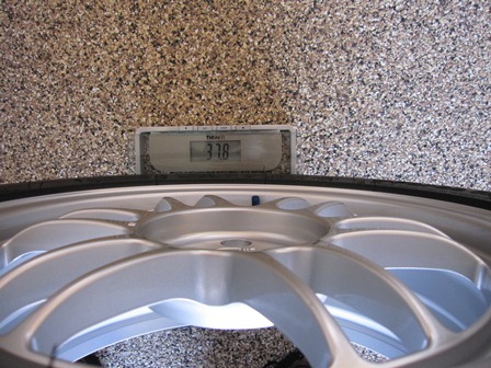

Enkei RPF1 17x7 & new BF Goodrich Rivals 225/45/17, 37.8lbs.

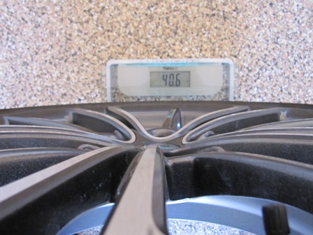

Stock wheel and tire weight 40.6Lbs ~2000miles on tires.

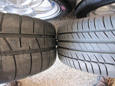

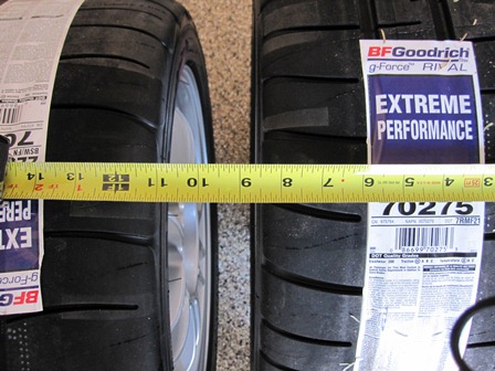

BF Goodrich Rivals 225/45/17 vs Stock Michelins 215/45/17
Name:  side by side.jpg
Tire tread width came in right at 8.5 inches.

looking good ..nice square tire profile

I rarely say this but damn, does it need a drop.

this must be the first pics of the 17x7, thank you. the 42mm offset looks perfect to me.
the rival's shoulder doesn't look too pleasing, but if it performs like they say it does, i want them too
I agree, but to remain in a stock class you really cant do anything to help.
It almost looks like a truck.

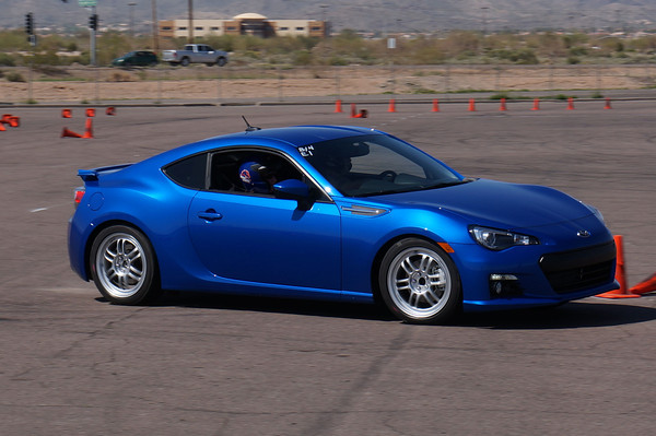

Ran last week with the new set of tires and wheels. I started off the day at 38psi front and 36psi rear.
The rear pressure seemed to work well, but had to bump up the fronts a few psi to get the wear in the right spot. I think I went to 44psi hot in front and that worked better.
I may have been over driving the car, I am new at this .
I think I will start with 40psi cold in the fron next event and see if this is a better starting point.
