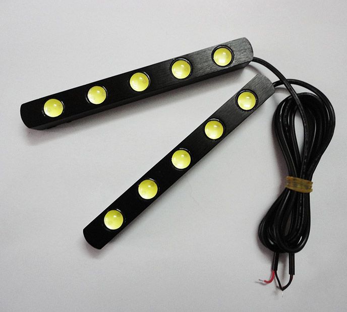

You could do a small LED strip with enclosure behind the stainless mesh.
Something like this. Just out of site till the lights are on. Thats just an idea but something along those lines.

I think that's what I'll have to do. Maybe find two small rectangular enclosures that can accommodate the existing bulbs and then splice in the connectors.
