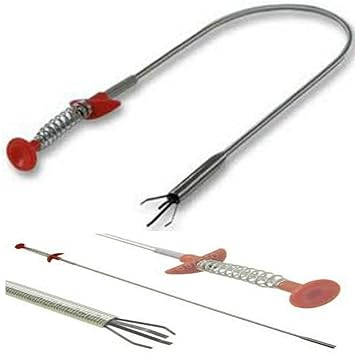

Is it possible to get at it with a grabbing tool? Sucks, man. I feel your pain.

Yea I tried using one of the grabbers. It was just too tight to get in
