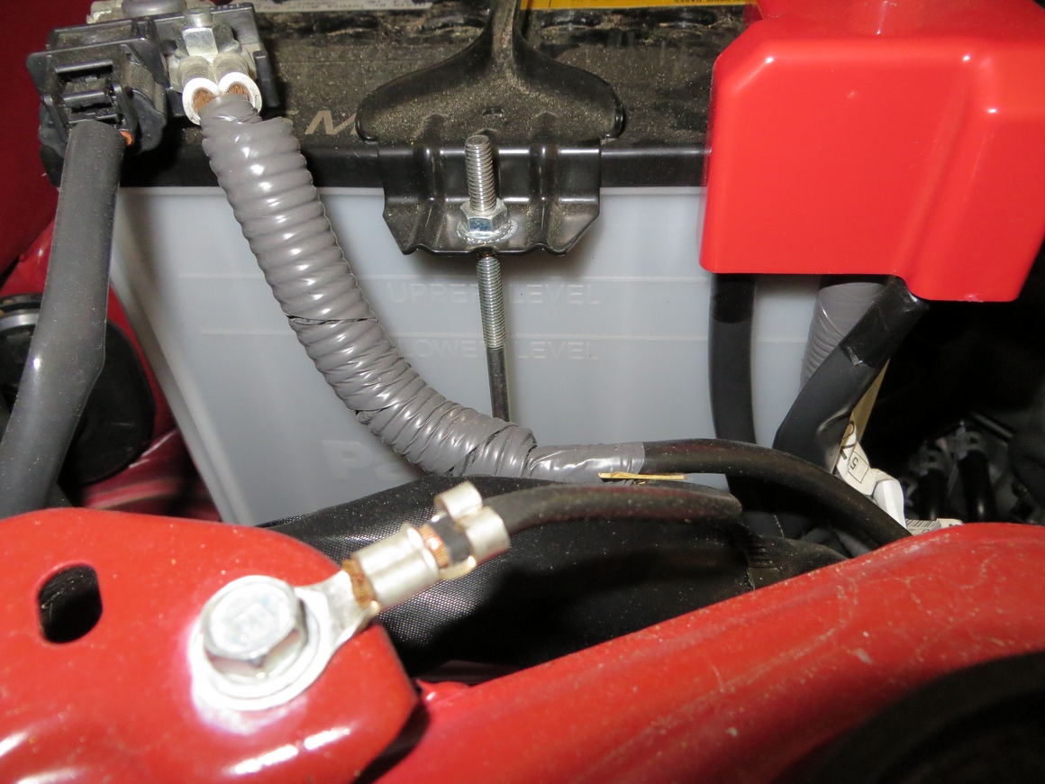

If you still have the original battery it has Lower and Upper level markings on the front of it. You should fill the cells with distilled water to just below or to the bottom of the cell tubes. The bottom of the cell tubes is about at the Upper level marking. Wear rubber gloves and safety glasses.

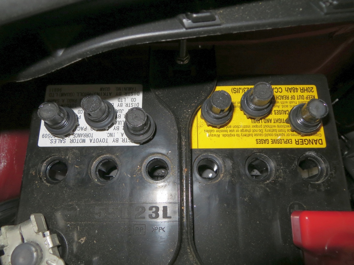

Screw off caps.

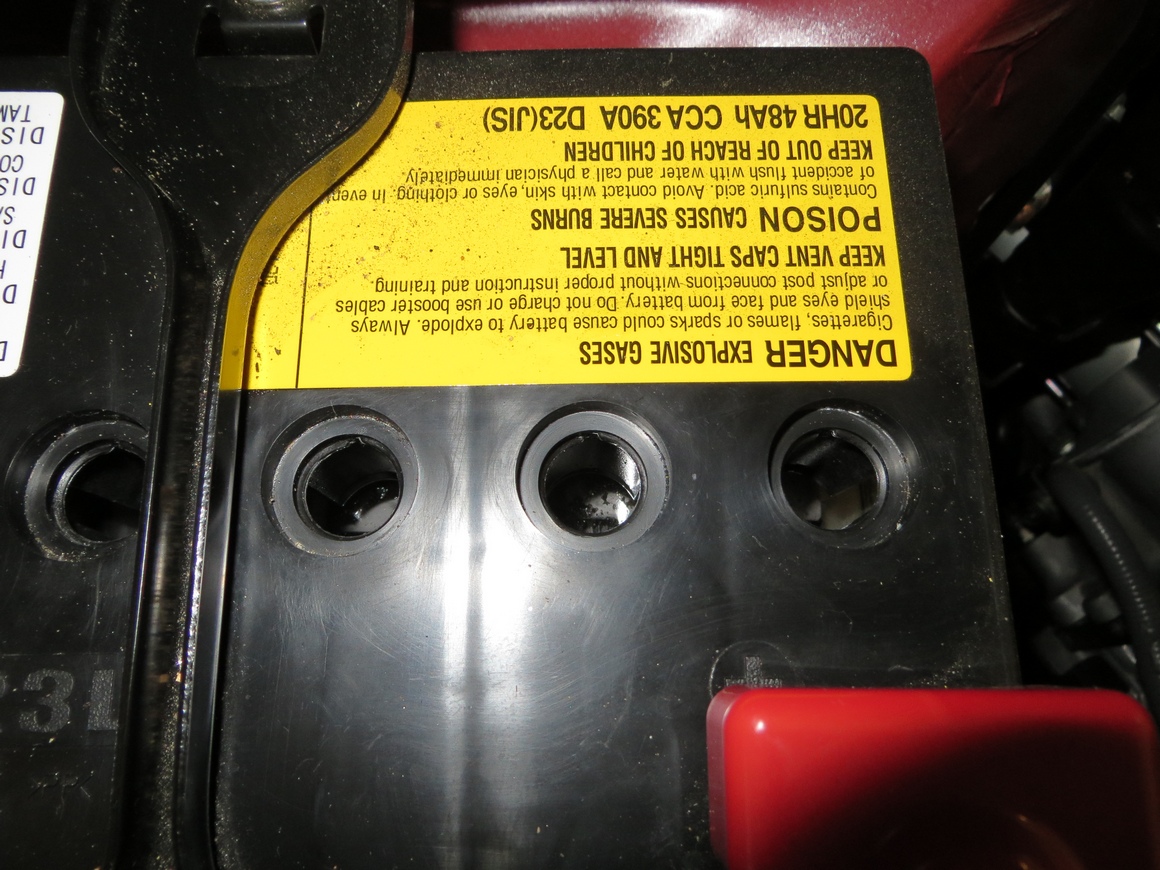

Water levels were low, just above the lead plates.

Upper and Lower level indicators

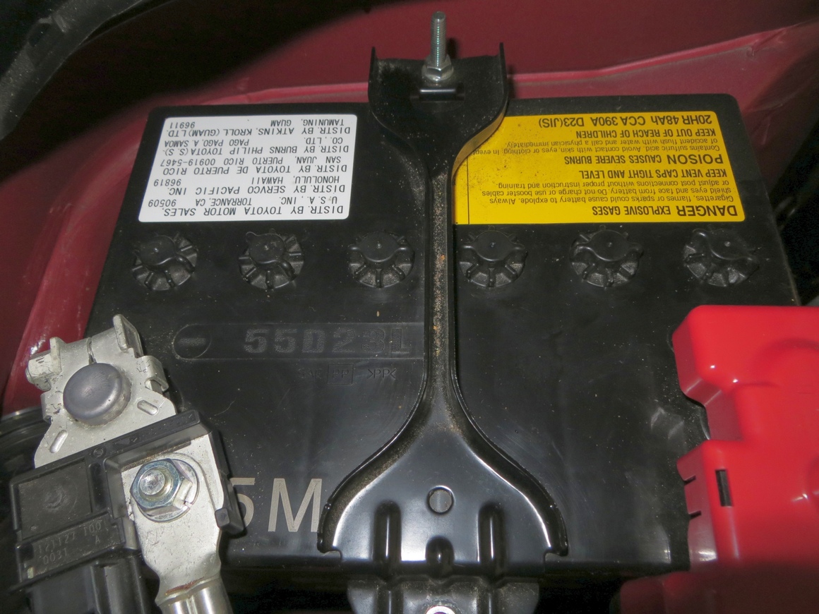

Added water to just below the cell tube bottoms

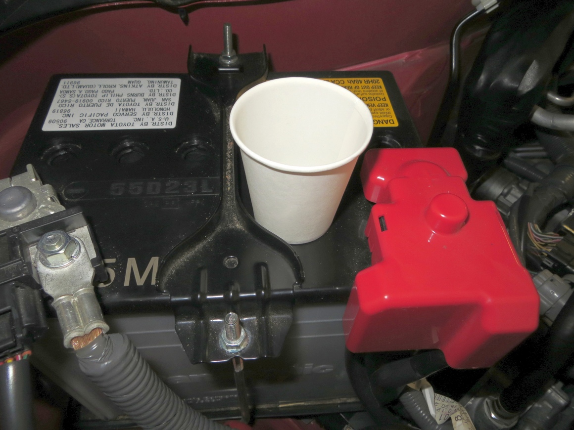

Use a small paper cup or syringe to add water to the cells
