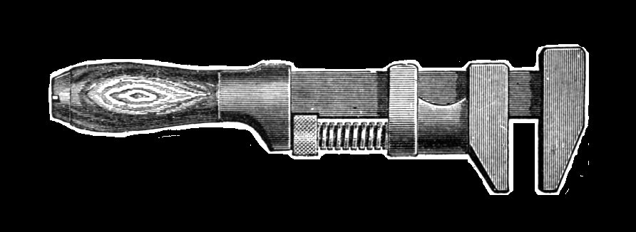

Oh, yes .... and DON'T stick the rod in your ear ...... stick the end of an old wooden handled screwdriver on the end of the rod and put that up to your ear ...... wooden handled screwdriver, you ask ...... yes, back in the day, screwdrivers had wooden handles, like monkey wrenches ......
OK, just improvise or buy a store bought scope.

Back in the day? I have some really nice wooden handled screwdrivers.
