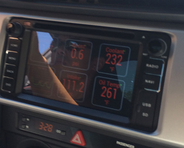

I installed this same setup in my BRZ last weekend.
Preface:
The car has the PTuning turbo kit and a Koyo radiator. I've been tracking the car and am looking for a solution to keep my oil temps down. I've seen 300ºF oil temps and 240ºF water temps at the track when running with no oil cooler.
The good:
When cruising with ambient temps in the 70s, water temp remained between 189º-195ºF and oil temp around 195º-200º. This was much better than the 215º+ I saw from just cruising without the oil cooler. On warmer days, oil temps while cruising could be in the 225º+ range with no oil cooler.
The bad:
The moment I get on the throttle and build boost, the oil temps would shoot upwards, just like before. While cruising with the oil temps at 200º and getting on the throttle, I would see the oil temps shoot up to 220º+. With spirited driving in the mountains, I would easily see sustained 235º oil temp along with 212º water temp.
The ugly:
Today, with ambient temps in the 95º-100º, I did some testing in the mountains. I kept it in 2nd gear to keep the revs high and was on and off the boost, but never WOT (not trying to fall off any cliffs). Within 5 minutes of this type of thrashing, the oil temp went from 235º to 260º+. Water temps started to rise along with it as well.
Unfortunately, it doesn't seem like this unit has the capacity to handle the heat generated from a turbo car.
