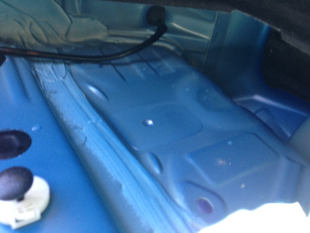

I went into the trunk of my BRZ and took off the rug on top of the spare tire I saw that there was a lot of moisture and took out the spare and there was a puddle of water and decided to take out the jack and all of the foam panels and there was also puddles of water under then. I took out the back seat to see where the water was coming from and there was even more water dripping under the rear seats . I called subaru and the guy there said that I needed to drop it off for a day or two just to see where it's coming from so I said screw that and took it to a car wash and dident see where it was coming from then I saw that is coming from behind the taillights on both sides Name:  ImageUploadedByTapatalk1362857193.105402.jpg
Drivers side
Passanger
Here's some of just the water when I found it Name:  ImageUploadedByTapatalk1362857260.005338.jpg
Size:  162.7 KBName:  ImageUploadedByTapatalk1362857269.654333.jpg
Size:  115.6 KBName:  ImageUploadedByTapatalk1362857278.821733.jpg
Size:  158.1 KBName:  ImageUploadedByTapatalk1362857290.221762.jpg
I called subaru back and they said that I still had to drop it off to see where it was coming from and why so I guess I'll have to make an appointment for later this week but is anyone else having this problem ?

This is related to the recently updated "Moisture in the taillights" service bulletin. Make an appointment with your Subaru dealer. If they give you any trouble, tell them to read the bulletin again. They should replace both taillight seals and install new, larger nuts, as well as inspect the taillight housing for cracks. Edit: The updated Service Bulletin explicitly states that the problem does not have to be present to perform the repair, so even if they can't reproduce it, they should still repair it. Edit edit: Is anyone else having trouble with post editing not saving formatting correctly?

I had this issue with my FRS, after i did my taillights and put them back on. The issue for me was the wire was closer to the car then the foam. IT should be under the foam or the water just run along the wire to a certain spot then drips into the trunk.

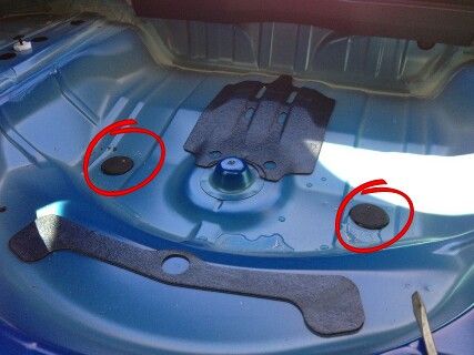

Had the same problem on my car, the water under the spare tire is because these
they do a terrible job in keeping the water out, so I sprayed some flex seal under both plugs. Water has stopped. You might also want to check this thread out
