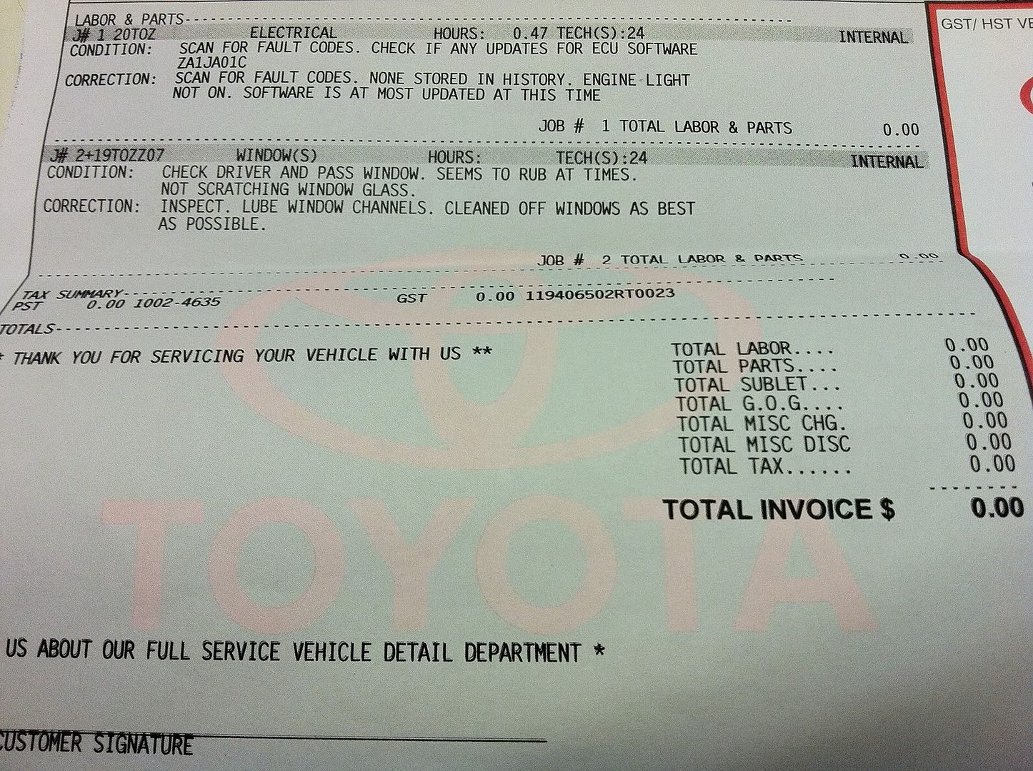

Old 08-28-2013, 08:36 PM   #348
Muaddib
Mentat
Muaddib's Avatar
Drives: 2013 Scion FRS 6MT
Location: Vancouver
Posts: 542
Thanks: 666
Thanked 358 Times in 198 Posts
Muaddib is offline   Reply With Quote
The Following User Says Thank You to Muaddib For This Useful Post:
jjaisli (08-28-2013)
Old 08-28-2013, 08:52 PM   #349
thill
Location: North Pole
Posts: 2,753
Thanks: 328
Originally Posted by Muaddib View Post
I don't think that confirms you have the correct software.
Old 08-28-2013, 10:35 PM   #350
Doborder
Godzilla Konvert
Doborder's Avatar
Drives: DMG BRZ Limited 6MT 2013
Location: Somewhere on earth
Posts: 215
Thanks: 47
Thanked 45 Times in 34 Posts
Tagged: 6 Thread(s)
Yes it does
Look below the first line
2013 Subaru BRZ Limited MT (DMG)
CO>CA Cartel
Doborder is offline   Reply With Quote
