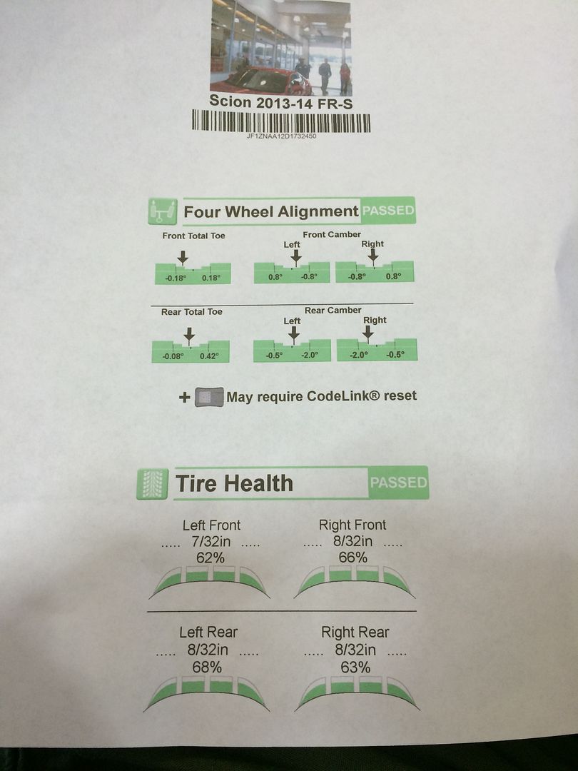

Alignment would be the first thing to check. I wouldn't be surprised if the rear toe was off due to the toe link adjusters (eccentric bolt assembly) slipping.
Plus I'm pretty sure these assemblies are all put together on the subframe and then bolted up under the car. The chances that the factory alignment is within spec, much less ideal, are pretty small.
The front is McPherson strut so it's going to be pretty good slapped together at the factory. The rear is more sophisticated and, ironically, precise alignment at the rear has much more effect on handling than the front end does.
This car handles so well that any mis-alignment is going to be very noticeable.

They just checked my Alignment this morning

So it looks like you're toe'd out in the back? That could be why. (unless I'm interpreting that incorrectly.

That's one of the worst alignment sheets I've seen Not the numbers...just in terms of how vague it is.
Anyway, it's hard to tell but it looks like you have a little toe out front and rear. I can't tell how much because that sheet sucks.

So it looks like they passed the alignment. But what is unclear is the toe left to right. The numbers are within factory spec, but I would not like the toe out on one side. If you are going to be off a little, it's best to be off equally on both sides... Was this a dealer alignment or an alignment specialty shop?

That was from the Toyota dealer this morning. When they tested it in the service lane. Also I know the old trick to tap the paddle to make the screen show it's in spec.
