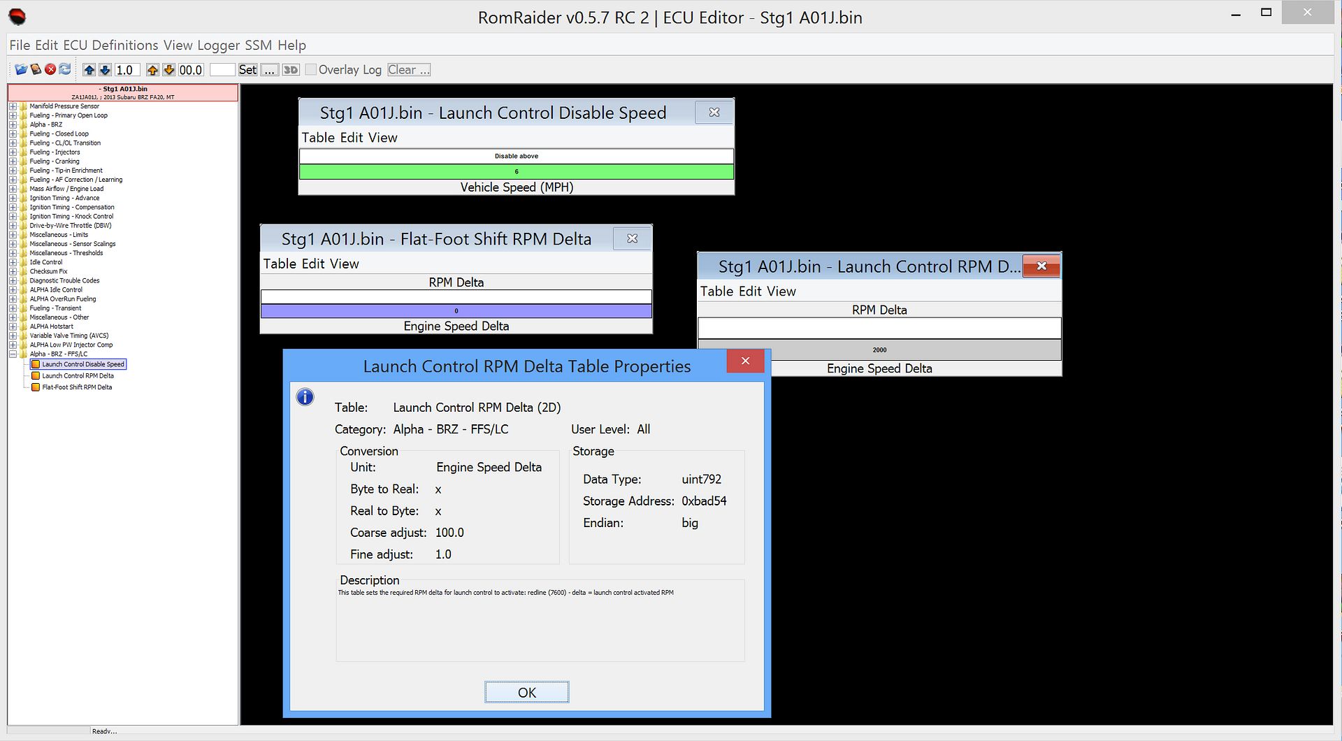

Is it easily adjustable?

Launch control adjustment requires you to modify a single field on the bin file, which is fairly easy. This current map release is on dev format which is not adjustable but the maps will be released in bin format once they are out of beta. Shiv noted that all future beta releases will follow this format so there will be a short delay period where the new maps will not be adjustable.
Yes, you can adjust it in the user tuning software (RomRaider):
