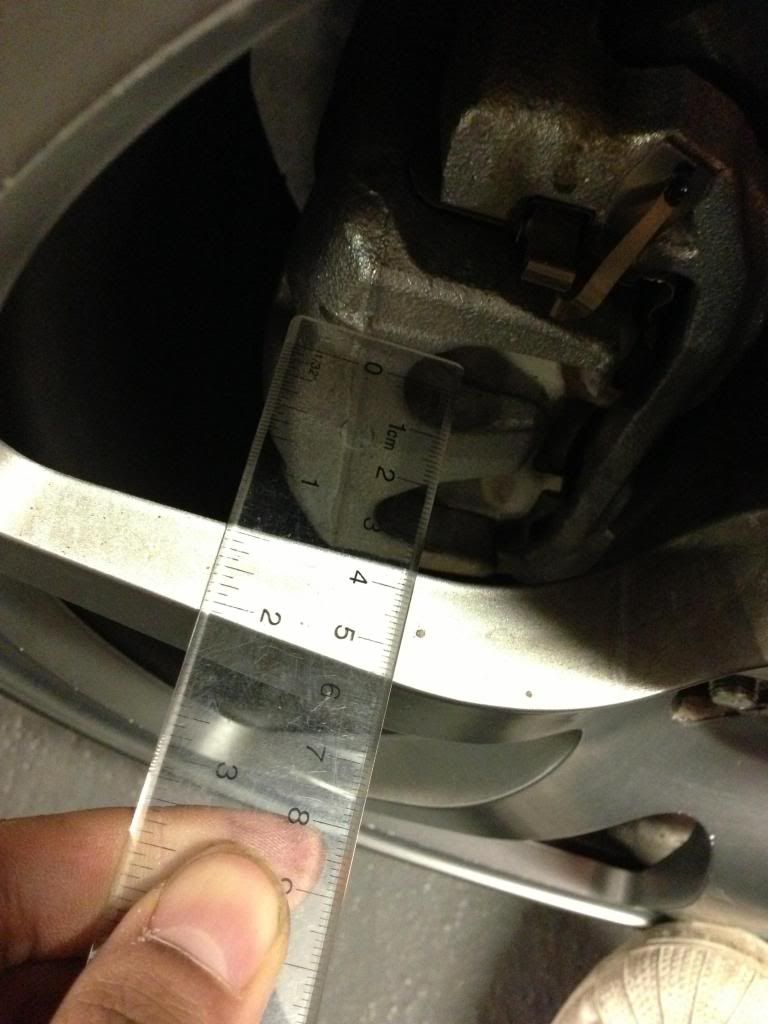

Originally Posted by fenixv8 View Post
I had purchased a set of Prodrive GC-07 in 17 x 7.5 + 48. What size spacer do you think i'll need to clear the new brembos?
Rims look like these ones
Thanks guys

Originally Posted by Racecomp Engineering View Post
Man those Prodrives are classic-ly noice !
Thats a semi back in the day wheel !
Myles
Ty man. Have the wheels but still havn't pulled the trigger on the sti Brembos.
Found a local set but I'm worried after I pick them up, finding out they won't fit on the wheels I just bought. =(

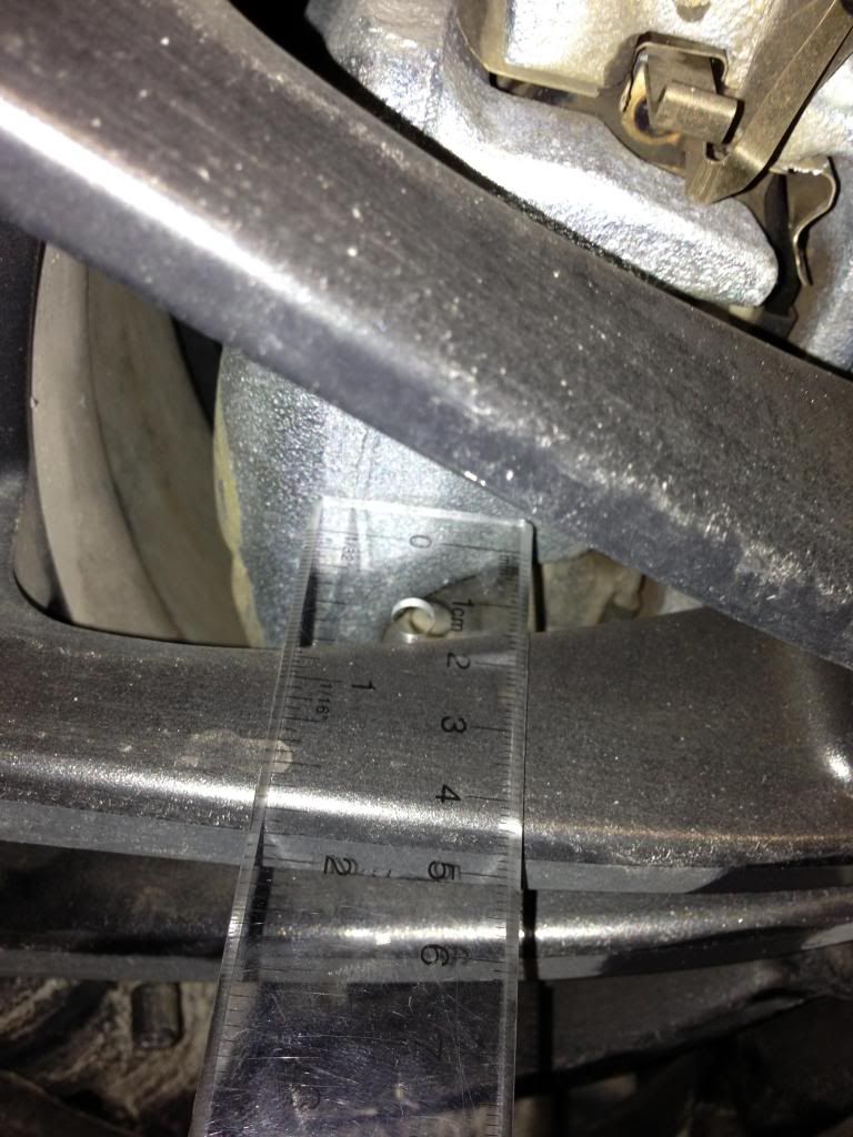

This is how much room I have over stock caliper with prodrives
and this is the stock wheel for reference
