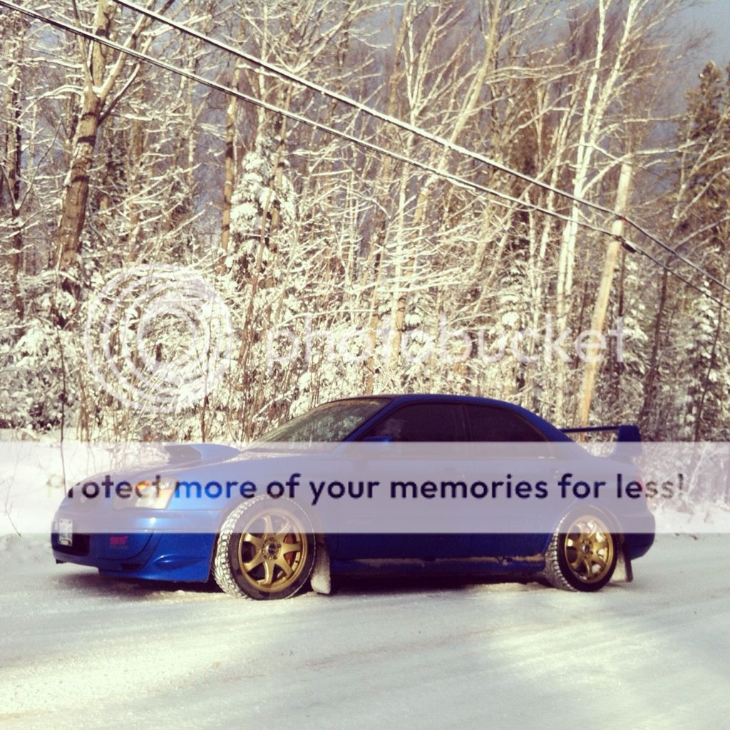

If you're looking for cheap 17" wheels that will clear brembo's check out the XXR 522's. I run the 17x8" with a +48 offset on both my STI and the BRZ. The goal was to add larger callipers on the BRZ so I chose a wheel I liked the looks of with the ability to add bigger brakes down the road. These come in flat black and chrome black as well. Also come in an 18x8.5 +48 for guys looking to run larger wheels. My 17's weigh 21lbs each.
Steve

Not a bad look
