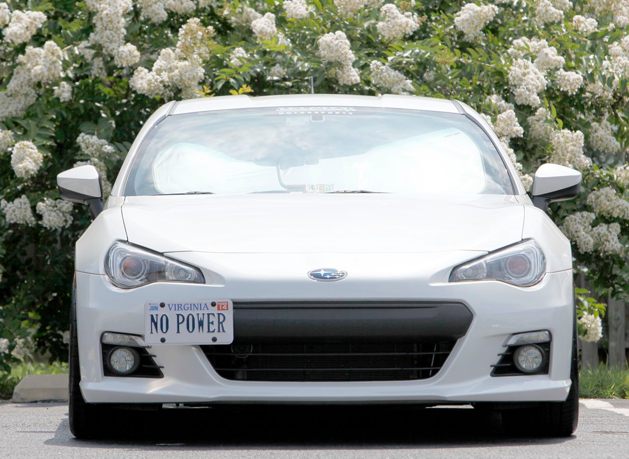

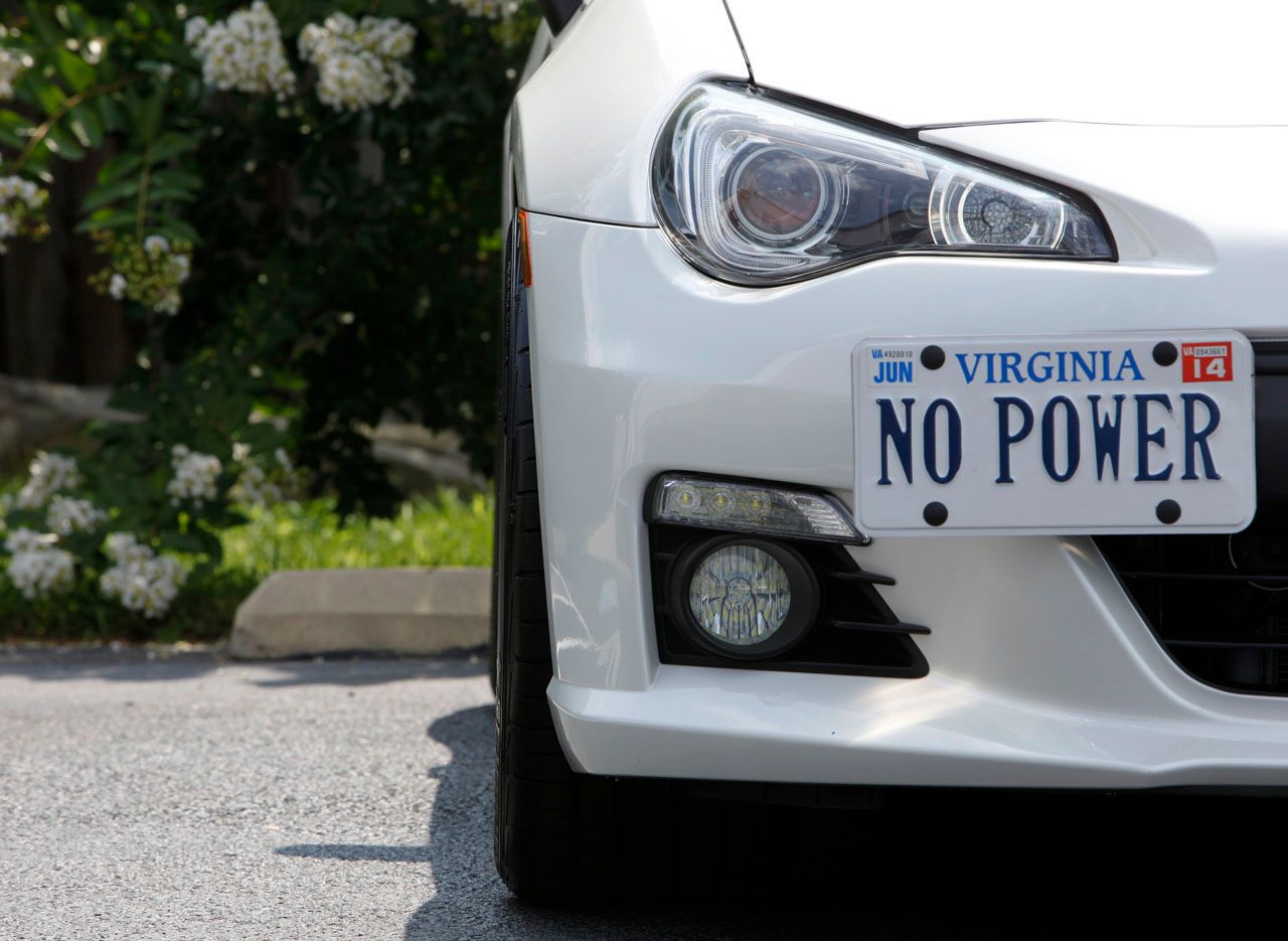

Originally Posted by raul View Post
Any possible fitment issues on 17x9 +35 with 255/40/17 all around on springs @ 1" drop?
I'd say. It'll stick out 7mm more than this, which is 17x9 +42 with the same tire size. This is with Whiteline Com-C upper strut mounts for -2 degrees front camber.
