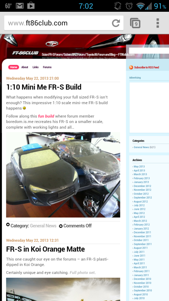

Your on the front page
Looking good.. Got to get mines up to like yours pro status but right now I have my buggies to maintain big race coming

Awesome!
