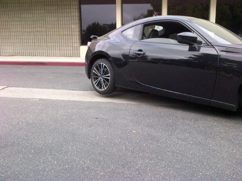

Originally Posted by Hanakuso View Post
Quit it with that..
When Mark replies back, I should be heading down to Eibach next week. Btw I did notice on a steep driveway my traction control going off and I heard a bunch of noise (Tings, clunks). I wasn't bottoming out but I played it safe and went a different way. I thought maybe one wheel was off the ground.
That is exactly what it is. One wheel off the ground and diff going crazy. Name:  ImageUploadedByTapatalk1369098547.465375.jpg
RAWR BRZ is offline   Reply With Quote

Originally Posted by RAWR BRZ View Post
That is exactly what it is. One wheel off the ground and diff going crazy. Attachment 38064
Yup, this.
Even with all the aids off, if tire spins, the diff/TCS will engage to stop the spin, so you can put power down. THe way our factory diff works, without the TCS kicking in, you're stuck; gotta have some sort of resistance on the lifted wheel for the other wheel to get power.
If you tripod like this with the Pedal Dance.... you're stuck.

Originally Posted by CSG Mike View Post
Yup, this.
To add onto that, we have torsen diff so tcs has to kick in for the wheel thats on the ground to work. and IF you have pedal dance on for some reason while stuck, use a bit of E Brake then the rear wheel that isnt in the air will spin
Pull the e brake a little
