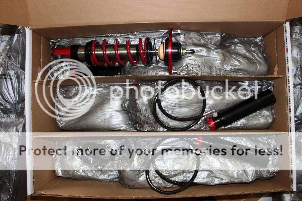

Unboxing/Install
So I decided to order them and here they arrived!

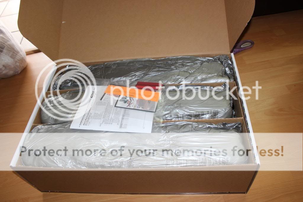

The coilovers inside were packaged very nicely and everything was well padded and protected.
Everything inside is already preassembled and ready to install.

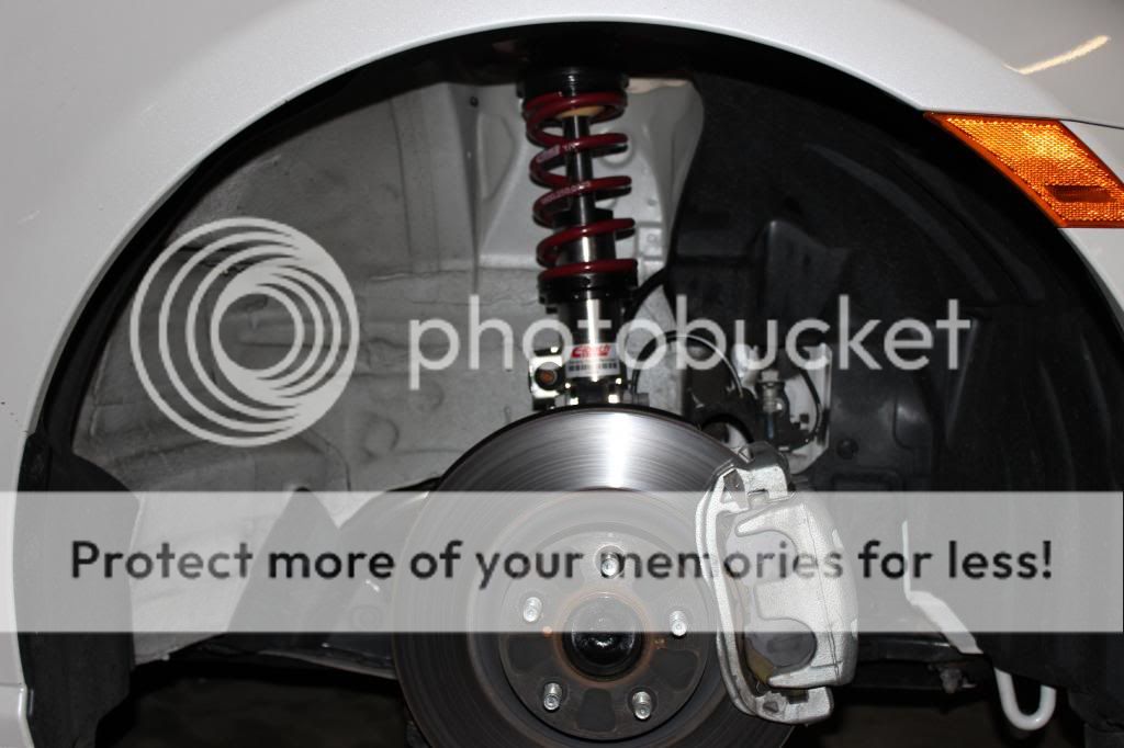

They came with an instruction manual that guides you through a step by step installation for those that want to intall them yourselves. Every step includes pictures of the actual installation on the FR-S so you know they really spent their time on the R&D for this vehicle and didn't just reuse a completely generic design.

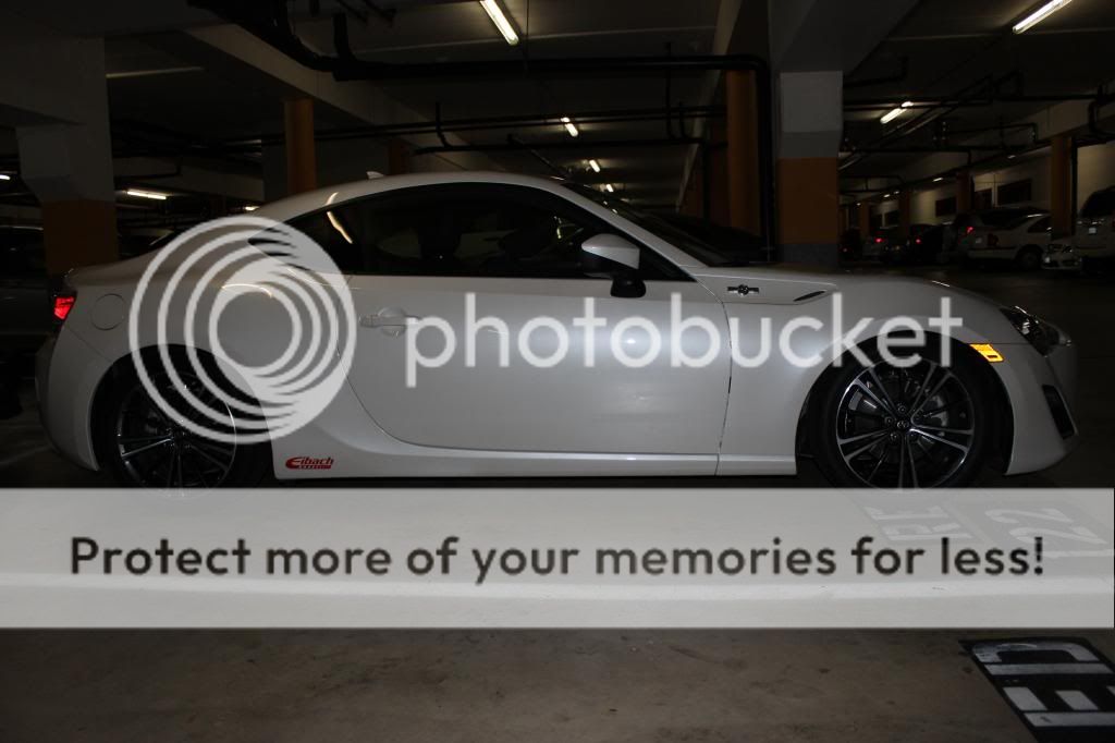

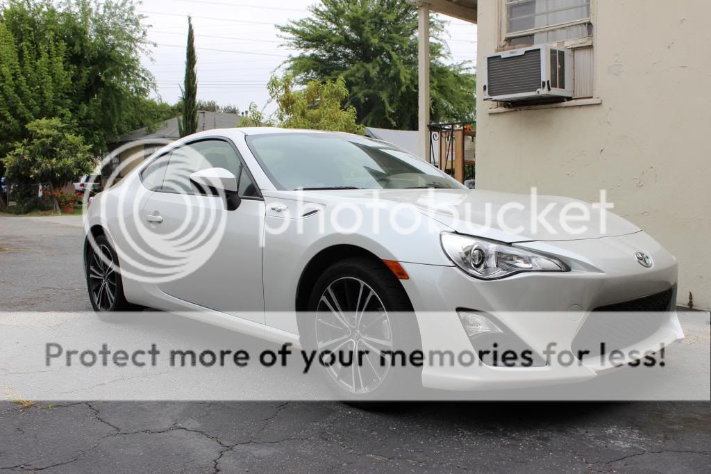

Before:
After: (I decided to drop it 1'' both front and rear)

Do you have a pic of the front strut mounted on the car with the wheel off? (not the reservoir).
- Andy
I actually don't :[ but I can get a pic of that too if you want.

No worries, if it's convenient then go for it but don't sweat it. Just trying to get an idea of how much bump travel they have at that ride height.
