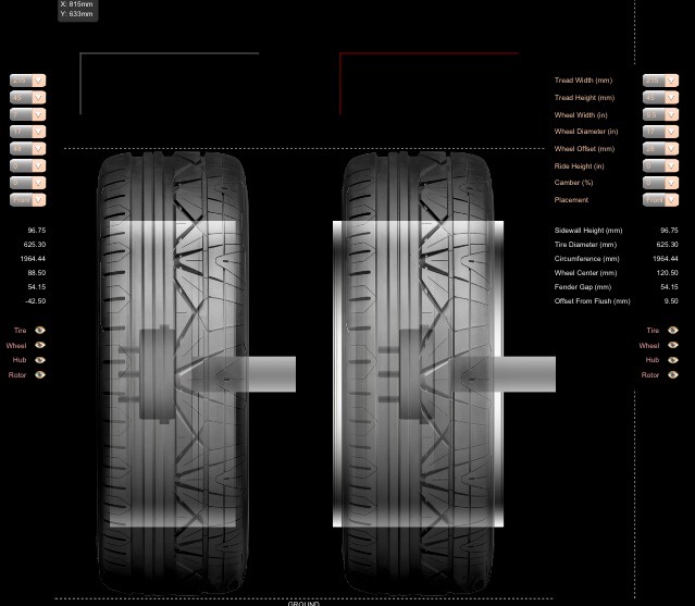

not gonna do RB til i go FI. so the FRS Project Calculator isnt accurate huh?
Whats not accurate?
Theres your front compared to stock
I have 9.5 +38 and i poke, so ud poke 10mm more

Originally Posted by jshadeck View Post
Whats not accurate?
Attachment 36882
coils + camber.
Rear: 18x9.5 +15 245/35 -2camber -1.6height
Front: 18x9.5 +28 245/35 -2camber -2height
JackSmiley is offline   Reply With Quote

Originally Posted by JackSmiley View Post
coils + camber.
Ok, so the tops of ur tires will poke less and the bottom will poke more lol
Camber does not affect the center of the rim, so the center (lug area) will be the same poke regardless of camber
U have the coils and camber currently? What rim specs? Cause if u have stock rims at that ride, i could tell you how much to measure off the face of the stock wheel to see where these would poke to
No, i mean what are u currently running as far as wheels/drop/camber?
Currently on tien h-tech, no idea on camber, with 18x8.75 +35 all over. waiting for the coils to arrive, once i got that in then im gonna replace my wheels and tires.
That setup is 7mm inside the fender, the purposed fronts would be 9.5mm outside the fender based on the web tool
