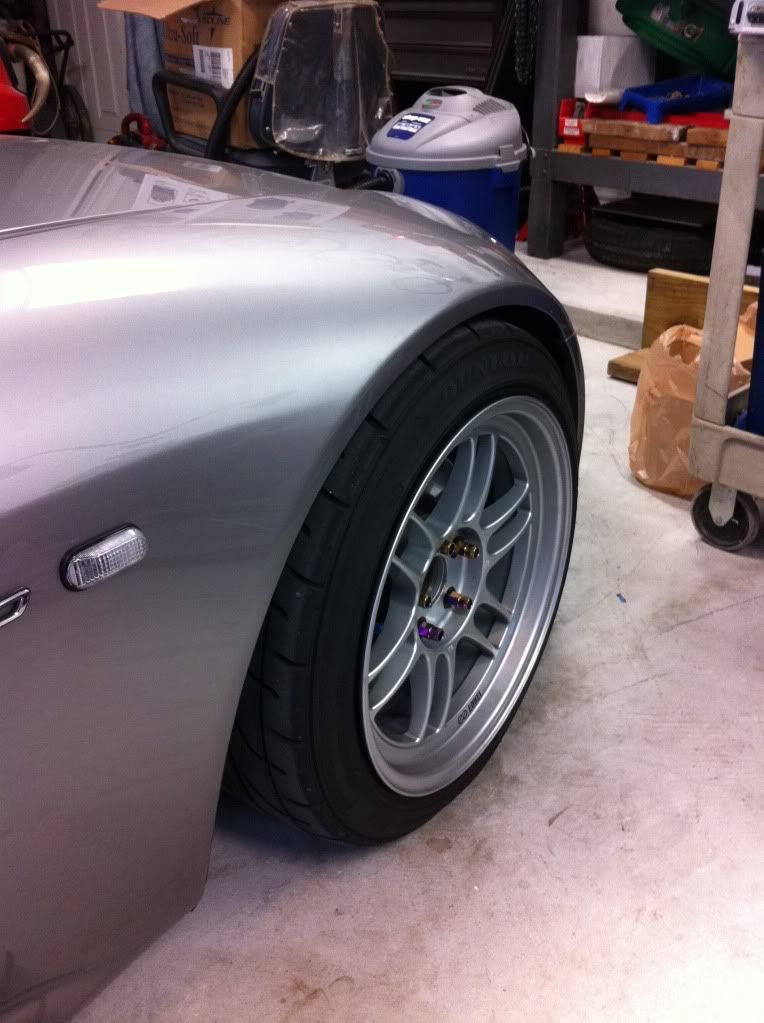

Contemplating on 17x9.5 +38 all around and stretching a 225/45/17. Planning on just crash bolts to get the -1.0 to -1.5 camber in the front and Swift springs for the 1" drop on stock struts. Yes I'm a ricer.
pic of s2ks doing it:
starspecs
Track duty i'd do a 245/40/17 g force rival on the same spec rim 17x9.5 +38. Would that hit the stock strut at +38 or should i just go the proven 17x9 +35 route?
xero404 is offline   Reply With Quote
starspecs
Setup should be fine with the +38

Im not so sure about that camber w a 245 and a drop clearing the front spring. Just my .02
Very close to rubbing the strut/inside.
ill86 is offline   Reply With Quote

guess i'll try to stretch the 225 rival then lol. wish there were more grippy tire choices in 235. or just bite the bullet and get coils already.
