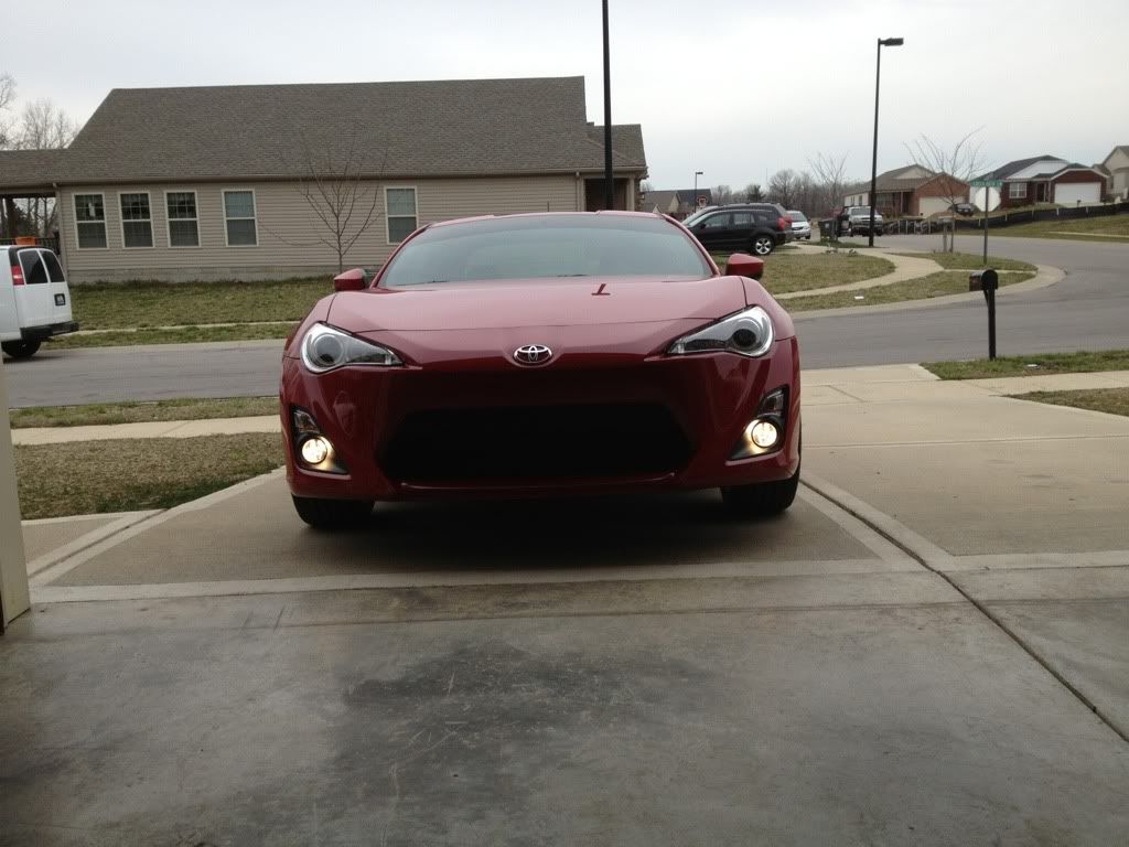

Got mine completed today.
Used the Tundra stalk and Nigel harness after a rewire to make it a negative tigger. One wire into the cab, the ground and attached to the white wire in the steering column.
One thing I didn't expect. With the headlights turned on the indicator in the dash works with the fog switch on. Turn the headligts off the fogs stay on and the indicator goes off. Turn on the high beams and the fogs and indicator turn off.
The fogs also stay on with the ignition off. I may go in a put them on a ignition switched circuit.

One thing you may want to change if you use Nigel's wiring harness. It has the ground for the lights and the ground for the relay trigger tied together. If you use the Corolla/Tundra stalk to ground the trigger you will be putting all the power through that thin little wire. I cut the ground for the lights and grounded them separately.

I have the circuit grounds separated. Even so I'm still leery of such small guage wire even it is just in the coil circuit. I wanted and still may try and find the output from the ECU that I posted earlier in the thread. Its difficult to understand the manual and track down the specific connectors and pin locations.

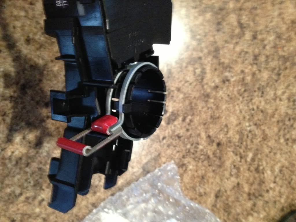

Everything I've read seems to indicate that the Toyota stalk (part number 84140-02670) DOES NOT have the auto position -- the only catch being that the retaining clip that comes with this one is too big and you'll need to remove & reuse the clip from the factory FR-S stalk.
If you google the part number, any pics that come up look like it's what you're looking for.
I have not ordered it yet, however I do intend to when I'm ready to complete this mod...
A note from my install. The retaining clip with the Tundra stalk worked fine. I did not need to change it.
Assuming its the clip with the red retainer attched in this shot.

Aah, I thought the retainer was part of the clip when I glanced at it. I just swapped it out so I wouldn't have to take it back off if the cover didn't fit.
