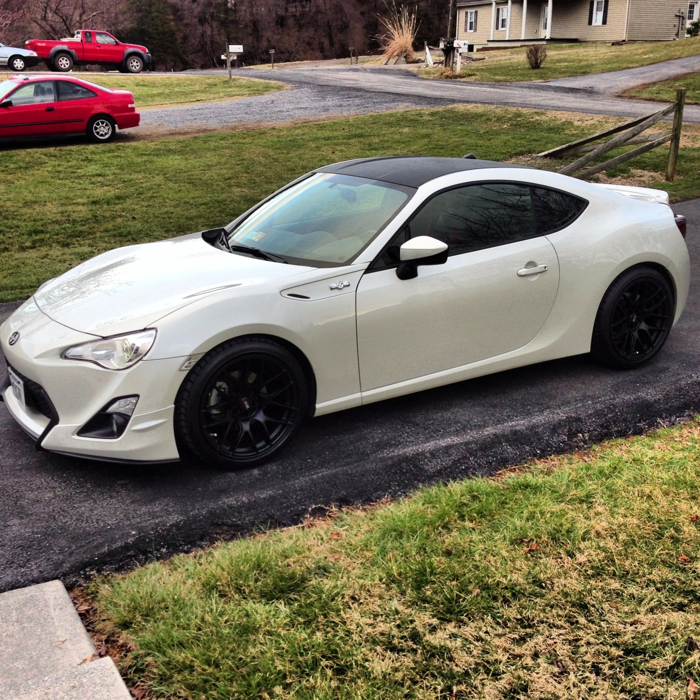

Originally Posted by DC-FRS View Post
Put my 530s on this week. Turned out great!
Thoughts?
Attachment 32366
Looks like sex to me bro,tuxedo look does you good
