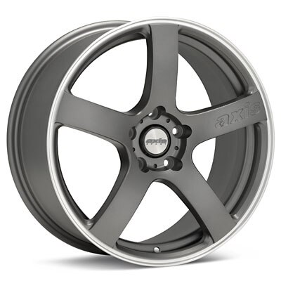

18x9.5, offset +45
Will it fit on the rear? I plan on using 245/35 tires but will 255/35 also work?
18x7.5 offset +45 with 225/40 going on the front, should be no problems there

18x9.5, offset +45
Both will work fine. To the last poster, 9.5 +45 is close on the inside rear. Tire selection/size is your choice. Grab a calculator and measure.

Originally Posted by madcap View Post
18x9.5, offset +45
2" of stagger on wheel width?? Any other sizes available in the wheel you are looking at?
Only other option with this wheel is to match the front's 7.5 width. I think the rim will look sweet on the Hot Lava I just ordered, even sweeter with fat rims and rubbers on the rear.
I don't care much about street handling. The car will be used as a daily driver commuter. I will keep the stock rims and fit some really sticky rubber to them for autocross events.
It's available in 8.5" too for the front, shouldn't have any fitment issues.
Oh crap, I didn't even notice the other option so 8.5" it will be. Even better. I may just go with 18x8.5 all around with 245/35 tires. I could then rotate them as necessary.
Good idea
