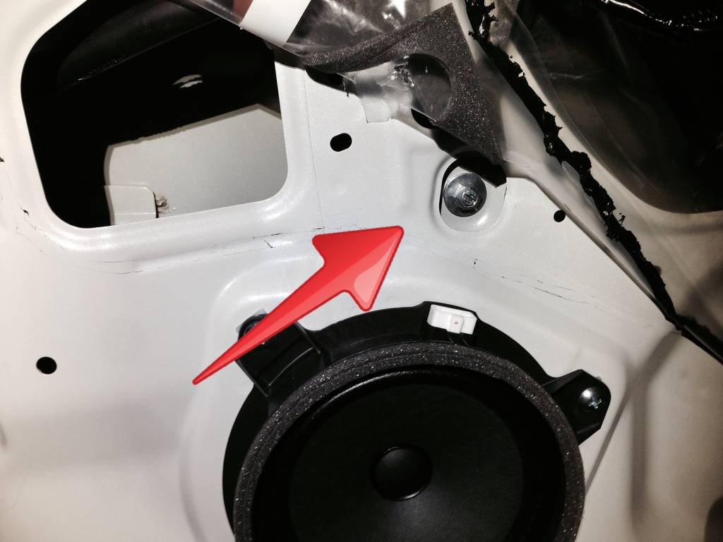

Mine had been back 3 times to have this fixed. In the end I did it myself. Best option is to align the window internally so it puts less pressure on the seal when it closes. Name:  ImageUploadedByTapatalk1404198315.013768.jpg
This is the relevant adjustment screw. Best to take off the locknut and understand how it works before adjusting. If this concerns you then take note of how you adjust so you can put it back.
