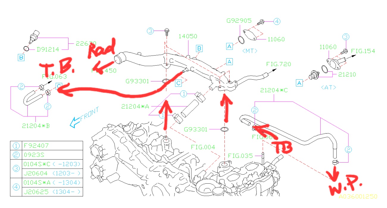

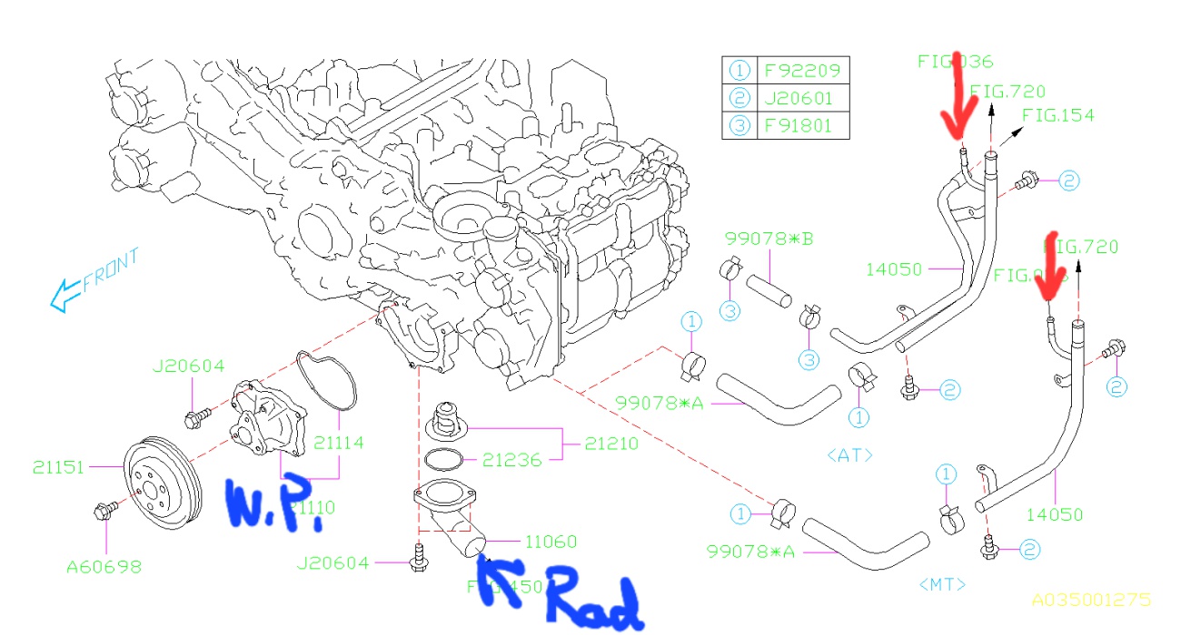

Originally Posted by Muskoka800 View Post
I’ll be installing the sensor block into the lower (larger diameter) rad hose.
The stock coolant temp sensor is located at the upper coolant gallery (14050 in the picture). Usually the hot side (upper rad hose) is used to get the temp as I know.

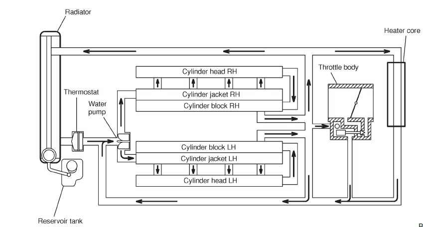

Originally Posted by makinen View Post
just came across this thread while searching for the coolant flow for our car, is this quoted flow picture 100% legit, according to the flow if we close the coolant line going in the throttle body with a valve (not uploading picture link:https://images.app.goo.gl/bngpSJPjUkEMtN2y8)
for summer days it shouldn't cause any issue/problem, and reopen it for 2-3 winter months.
