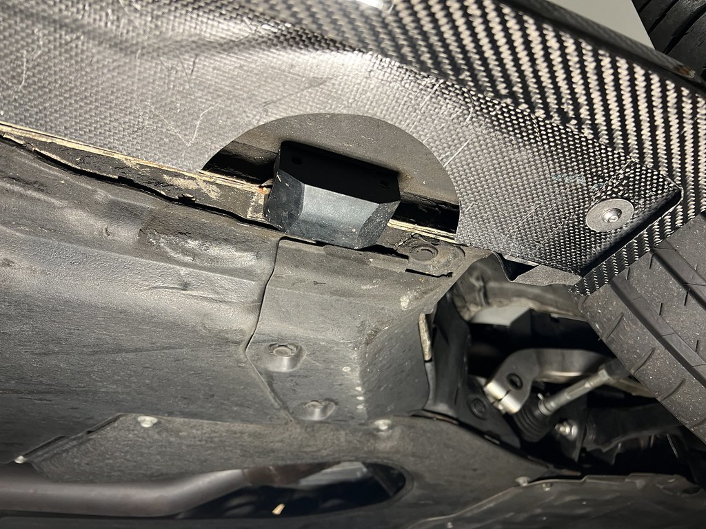

I use some short ones that I picked up off Amazon. I wouldn't get the long ones you posted as it'll get in the way of aftermarket skirts.

I would like something to take the pressure off the vertical pinch weld. I don't think those do that, as they don't look tall enough to transfer the force from the jack to the horizontal portion of the body on either side of the pinch weld.
I have no interest in putting side skirts on my car, so that's not really a concern for me.
Attachment 217794
Attachment 217795
I saw this kind recently and was wondering if they were worth picking up. Most of the ones for domestic cars seem to get bolted onto the car.
