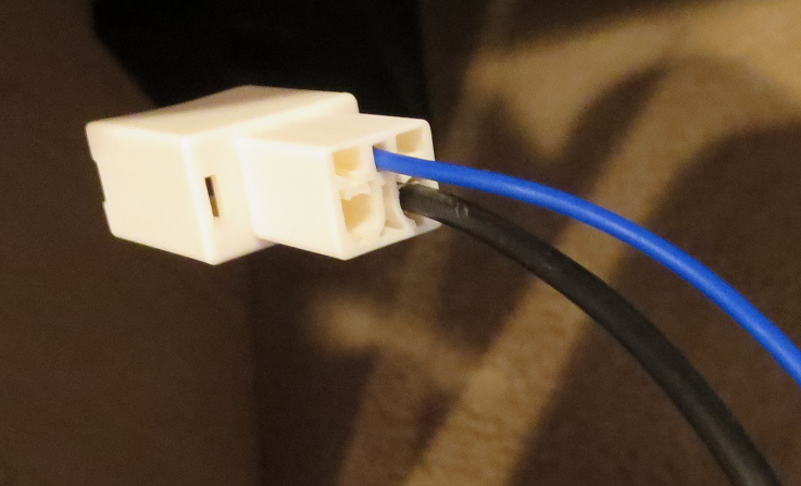

If your antenna adapter harness does NOT look like this one,
and it is missing the blue wire, then they need to send you the correct antenna adapter harness, because that blue wire in the picture here needs to be powered with +12 volts to power the antenna for proper radio reception.
