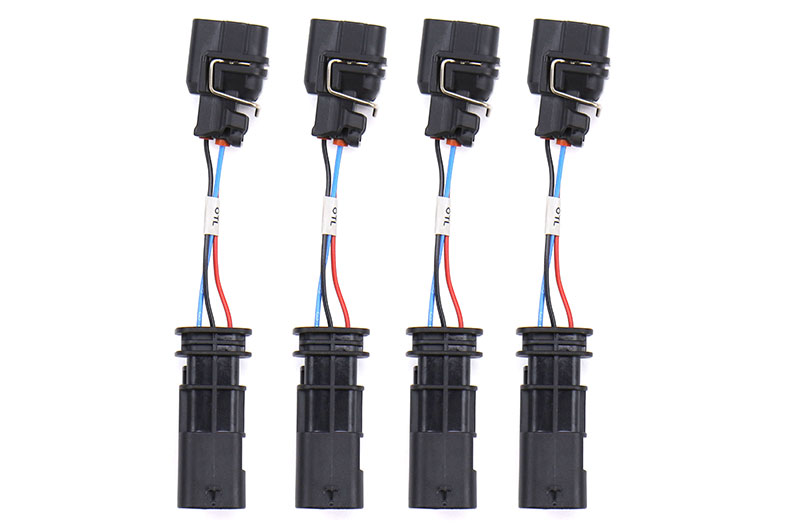

Anyone give this product a shot yet? I am curious about quality. I found a set of 2015+ coil packs a while ago for a steal so this could be a good low budget option to solve the 2013-2014 coil pack issues. I ordered a set and will report back on the install and results.
https://www.icefabrication.com/produ...grade-to-2015/
Just putting this out here for an additional source of materials for anyone in the same situation as you.
https://www.iwireservices.com/produc...or-brz-and-frs
Now that I am seeing this, I wonder if I could just de-pin the current 2013 connectors and put the OEM terminated crimps into the 2015+ connector......I might have just spent too much money on pre-terminated pigtails.
I reached out to both companies asking if the terminal pins are the same on the 2013-14 and 2015+. I will report back when I get a reply.

Ice Fabrication replied stating they tried looked into the pins and they are in fact different. So new pins are required.
There's also this
https://www.ftspeed.com/part/coil-ad...t#.YW2ir1XMIuU
Joon525 is offline   Reply With Quote
I JUST remembered that. Maybe it's not too late to cancel your order though?
Thanks. Ice Fab was really understanding. I will snag those from FT86 Speedfactory instead

Originally Posted by radroach View Post
@Takumi788 what are the coil pack issues on '13-14?
The 2013-2014 coil packs fail when in high demand environments like the racetrack or boosted applications. Subaru/Toyota upgraded them somewhere mid-2014 to a more heat resilient coil pack. Unfortunatly when they did this they changed the connector. So they are not a direct replacement. Thus this thread.
